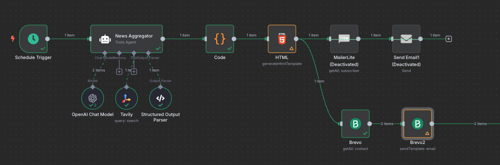

Failed to populate placeholders with array of objects using Brevo repeatable content and n8n
Brevo is able to send out the email but the items supposed to be looped over and displayed in the email is not showing up at all. What did I do wrong? thanks

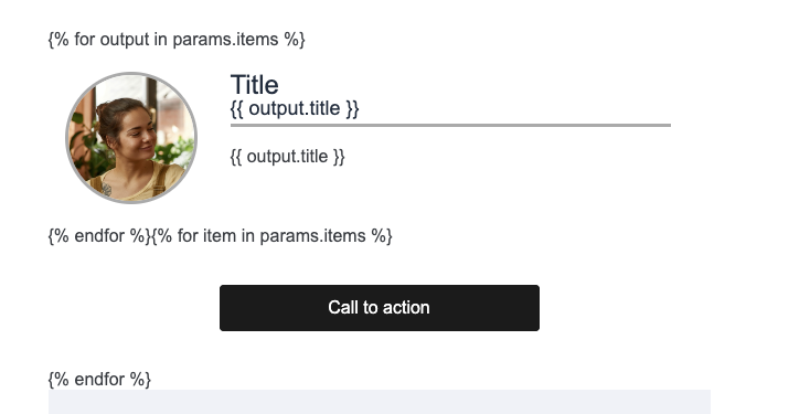

Brevo Template

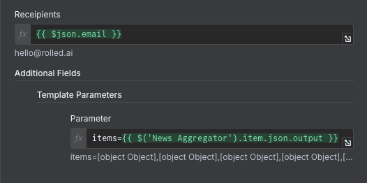

I have a key called items in brevo template parameters
I tried to loop through param.items but the final email returns empty without the content

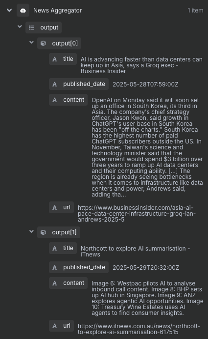

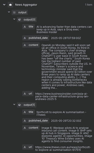

This is the structure of the items parameters passed in, to be looped over and displayed

  • After the News Aggregator node, add a Split node.
  • Split all the entries using the key output.
  • This will break the data into multiple individual items.
Once the data is split:
  • You won’t need a loop.
  • Just use expressions as usual…n8n will handle each item individually in the following nodes.
