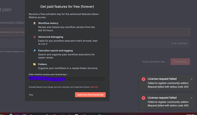

Failed to register community edition: Request failed with status code 403
I’ve faced Failed to register community edition: Request failed with status code 403.
How can I get the license? where I’ve used many methods, but unfortunately I couldn’t find a solution.

Yes, I also encountered the same problem. I deployed it using docker on the windows system. Is there a solution now?
I ran into this error when running n8n locally with npx n8n.
The issue turned out to be that the license activation endpoint requires an HTTPS URL. By default, npx n8n serves over plain HTTP (http://localhost:5678), which causes the 403 error.
Solution: Run n8n with tunnel mode so it gets a valid HTTPS URL:
npx n8n start --tunnel
This provides a secure, HTTPS-accessible URL, and the license registration works without the 403 error.
If you don’t want to use the tunnel, another option is to set up your own HTTPS reverse proxy or SSL certificate for your local instance.

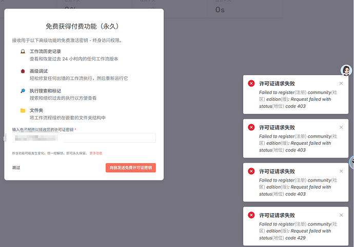

我也和你一样,朋友你解决了吗
anyone able to get a community edition key?
I have already solved it. The solution is for your reference, and the activation code has been successfully applied for.
我已经解决啦,解决方案供大家参考,已经成功申请激活码。
步骤一:启动 ngrok 并获取 URL
  1. 确保已安装 ngrok。如果没有安装,可从 ngrok 官网 下载适合你操作系统的版本。
  2. 打开终端(在 Windows 上可使用命令提示符或 PowerShell,在 macOS 或 Linux 上使用终端)。
  3. 运行命令启动 ngrok,将本地端口(假设 n8n 运行在本地 5678 端口)暴露到公网:
ngrok http 5678
  1. 执行上述命令后,ngrok 会启动并显示类似如下的信息,其中 https://xxxxxx.ngrok.io 就是我们需要的公网 URL(复制这个 URL)。
Forwarding                    https://xxxxxx.ngrok.io -> http://localhost:5678
步骤二:在启动 n8n 的 Docker 命令中添加 WEBHOOK_URL
当使用 Docker 运行 n8n 时,通过环境变量来设置 WEBHOOK_URL。假设之前运行 n8n 的 Docker 命令类似:
docker run -it --rm -p 5678:5678 n8nio/n8n
现在,要添加 WEBHOOK_URL 环境变量,修改命令为:
docker run -it --rm -p 5678:5678 -e WEBHOOK\_URL=https://xxxxxx.ngrok.io n8nio/n8n
这里将 https://xxxxxx.ngrok.io 替换为你在步骤一中从 ngrok 获取到的实际 URL。
这样,通过这个公网链接申请激活码,就可以申请成功。
