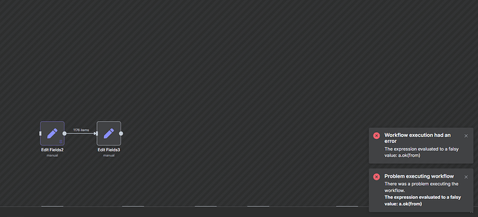

‘falsy value: a.ok(to)’
This is the same question as the now stale
TL;DR: doesn’t let me run anything with this strange error, regardless of anything. must do hard browser refresh each time.
the workflow doesn’t matter, it happens on every single node, regardless of configuration.
I can run once, and then the error prevents a consequent run.
After ctrl+shift+R, can run once more, and then again.
It’s impossible to work like this.
The only solution I know is to downgrade to 1.80.5 (now 1.92 but also happens with latest 1.95], but that’s no solution, it doesn’t have basic important features like the ai agent.
Is there ANY workaround? not even hoping for a solution

Hi, I had the same error.
Randomly a workflow stoped working. I’ve noticed that a lot of people have reported this with new updates and haven’t seen a clear answer on why it’s happening.
This is serious, if you don’t setup alarms there no way of knowing that the workflow is failing…
After some testings in the workflow that presented this error the behaviour of set nodes was extremelly erratic.
Saw a user fixed this by copy and pasting the workflow into a new one and that also fixed the problem for me. Unfortunatelly I errased the previous workflow and I can’t provide usefull information but from what I’ve tested It seemed to be an error with set nodes. (I didn’t had any from in my workflow and randomply stopped working).
