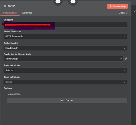

I want to fetch the prompts and resources inside the mcp tool that configured, right now MCP client tool node is only fetching available tools inside the MCP server.
How should I fetch prompts and resources out of that MCP server

Thanks @Hafiz_usama,
can you tell me how we use that in inside the n8n.
There are two ways:
A. Using the same MCP node (if supported by your build)
  • Check if the MCP node in n8n allows selecting the method (listTools, listPrompts, listResources).
  • If yes, just switch the dropdown from listTools to listPrompts or listResources.
  • Then execute and you’ll see the array of prompts/resources.
B. If your MCP node doesn’t expose those methods
  • Use an HTTP Request node in n8n, pointing at the same MCP endpoint.
  • Manually call the MCP methods.
    “method”: “listResources”,
    “params”: {}
    Authentication is the same as you configured (Header Auth with your credential).
  • This way you’ll get back the JSON of prompts/resources.
