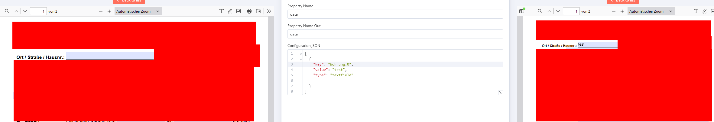

I extracted all form field names with Stiling PDF
and tried entering data using the node above, but it doesn’t work.
It may be related to the file being XFA-Format.
What you can do is, print the PDF as PDF (removing all fields etc), then add Form fields yourself, using Adobe Acrobat, or another able programm.
Use a node like the one above to fill your custom pdf form…
this does not work properly for me it does not return the pdf correctly
