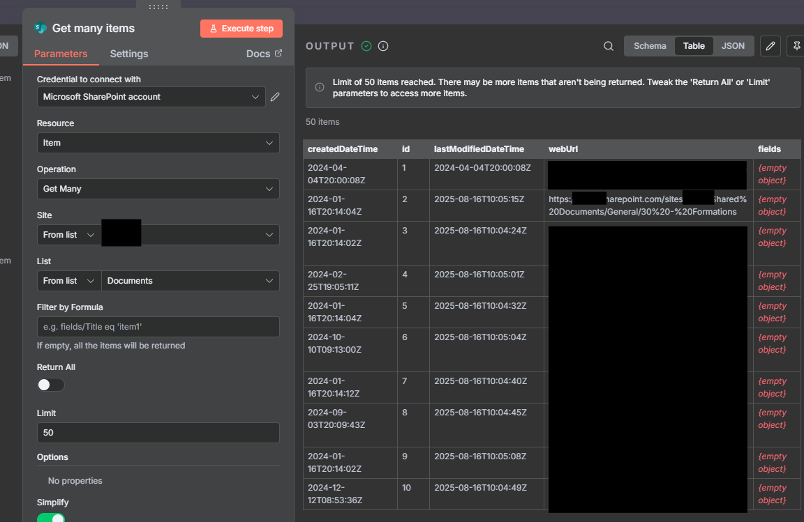

I want to search some Sharepoint folders.
When I ask whthout any filter, it works :

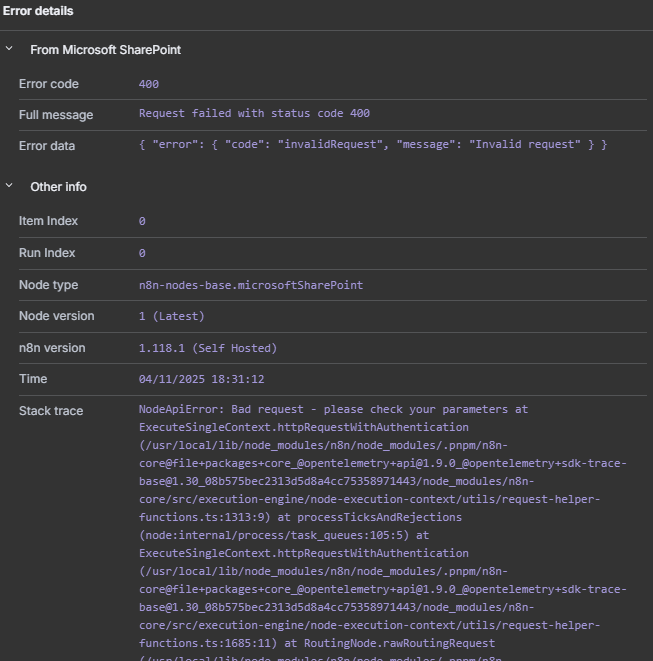

When I try to filter with “Filter by formula”, it does not work anymore.
Some filter examples I tried :
No workflow, only this node
Error code 400

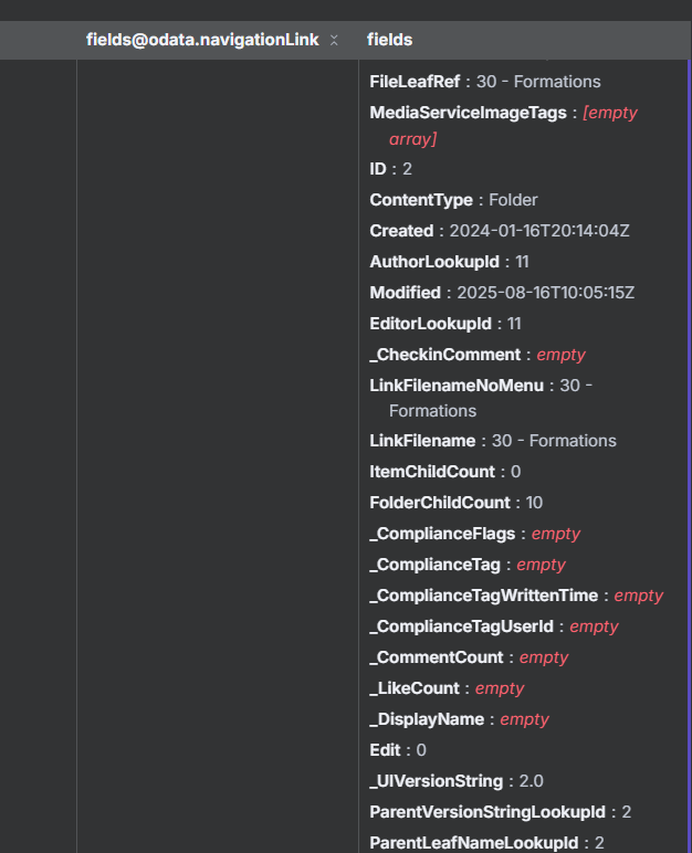

It doesn’t work (if I well-understood what you said). As per example, you can see what I can have when I do not type any filter :

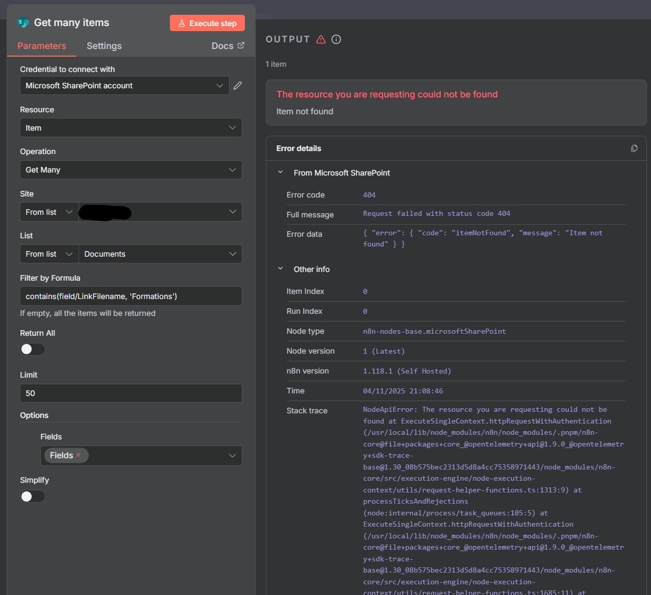

but, when I try a filter, I have an error :
contains(field/LinkFilename, ‘Formations’)

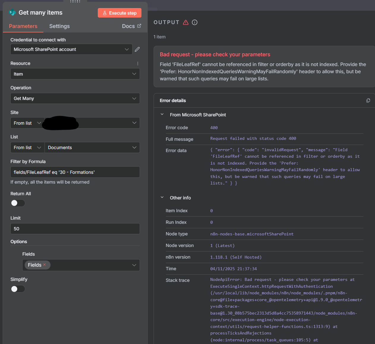

try contains(flelds/FileLeafRef, 'For')or fields/FileLeafRef eq '30 - Formations') for specific files.
I also read about FileLeafRef, didn’t mention it here tough, tought past ones would work. These must solve your issue. Keep in mind that eq means equals so you might need to write the exact same name when using it.
There is a progress. The error is still here but this is not the same message !
The field seams to be not searchable.
How to knows which ones are searchable and which ones not ?
It worked actually, just that FileLeafReffield isn’t indexed, so it returns this error. This is how Sharepoint protects slow queries if the list is too big. You have a couple of solutions:
→ Go to Sharepoint Dashboard, Settings, Columns, and add FileLeafRefas indexed column.
→ Use an HTTP Request node instead, and add a header(Prefer) with this value in your request: HonorNonIndexedQueriesWarningMayFailRandomly.
→ You can also send a GET request to this url: https://{tenant}.sharepoint.com/sites/{site}/_api/web/lists/getbytitle('YourList')/fields?$select=Title,InternalName,Indexed,Filterable,Sortable,Queryable to retrieve fields that you can use in your filter.
But, adding the FileLeafRef as indexed column seems easier so I recommend doing so.
