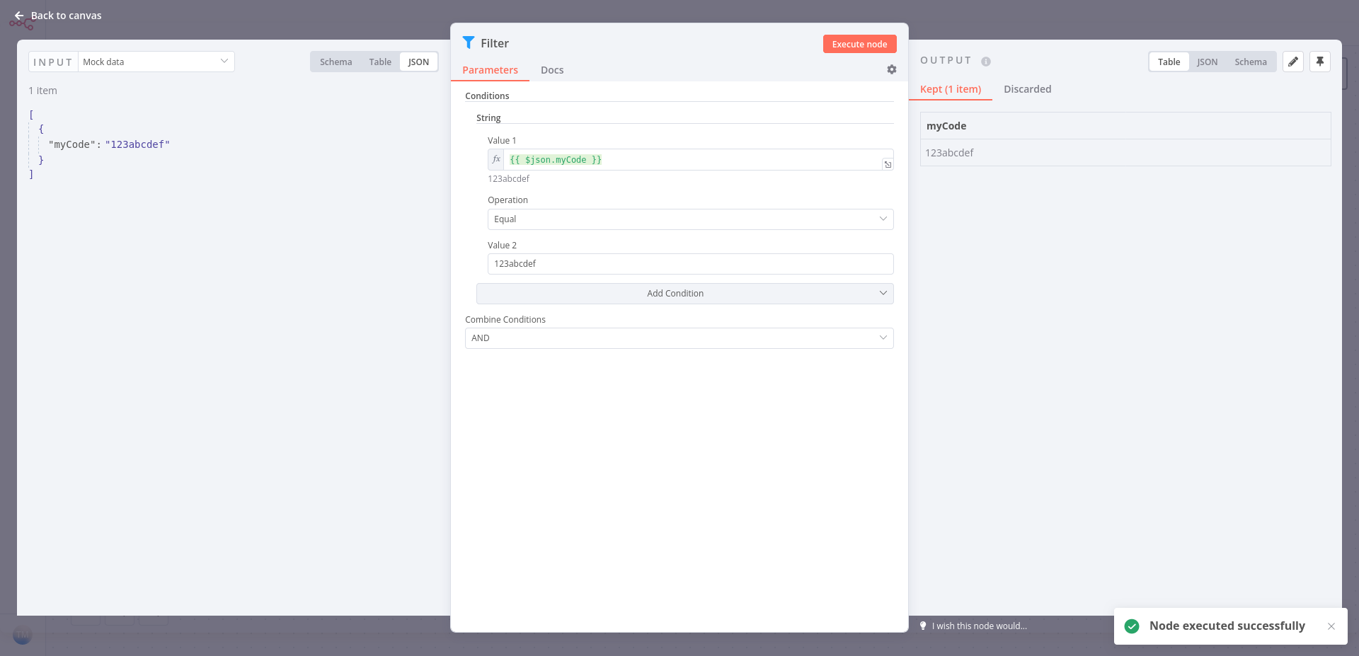

In general, the equal operation worked fine for me when testing it just now on [email protected]:
My example data is sent to the “Keep” branch as it should when comparing a field from a previous node. This was using the below workflow:
So perhaps you can share an example workflow using which your problem can be reproduced and confirm the exact version of n8n you are using?

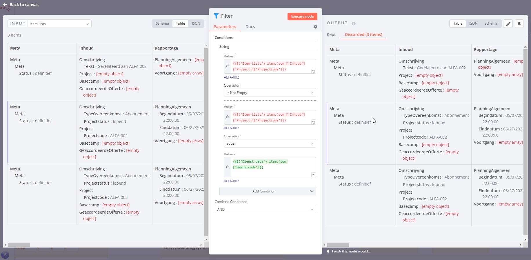

This is a screenshot of the problem, i cannot share the workflow, as it contains sensitive data…
You can see that it recognises ALFA-002 but it evaluates as discarded/false. We cannot figure out why. With the contains opertation it works fine.
This looks like there might be a line break in your Value 2 field causing it to differ from what you have in Value 1. Can you make sure there are no trailing/leading white spaces or other characters in your expressions?

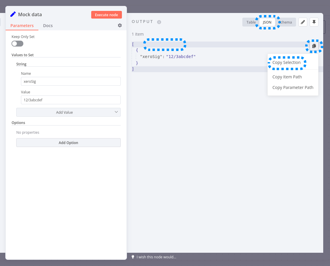

If the problem still persists, can you share the JSON data from each node you are comparing data from? You can copy the actual data by selecting the top line in the JSON view, then use Copy → Copy Selection:
You were very sharp yesterday :wink: There was a linebreak in Value 2 field! That solved the problem!
