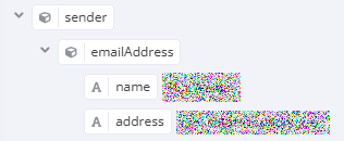

in the meantime I confiured in the trigger:
hasAttachments eq true AND subject eq 'bon' AND from/emailAddress/address eq 'mymail'
With your syntax I do not get any data.
contains(subject,'{{ $subjectFilterText }}')
Does Graph API supports contains or startswith?
In your links I cannot see something similar with your example

I edited my post. Forgot part of the expression syntax for n8n.
I always have to experiment with combinations of filter clauses. I’m sure once you search and read enough examples, you’ll zero in on what you need.
