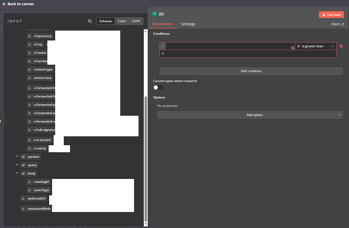

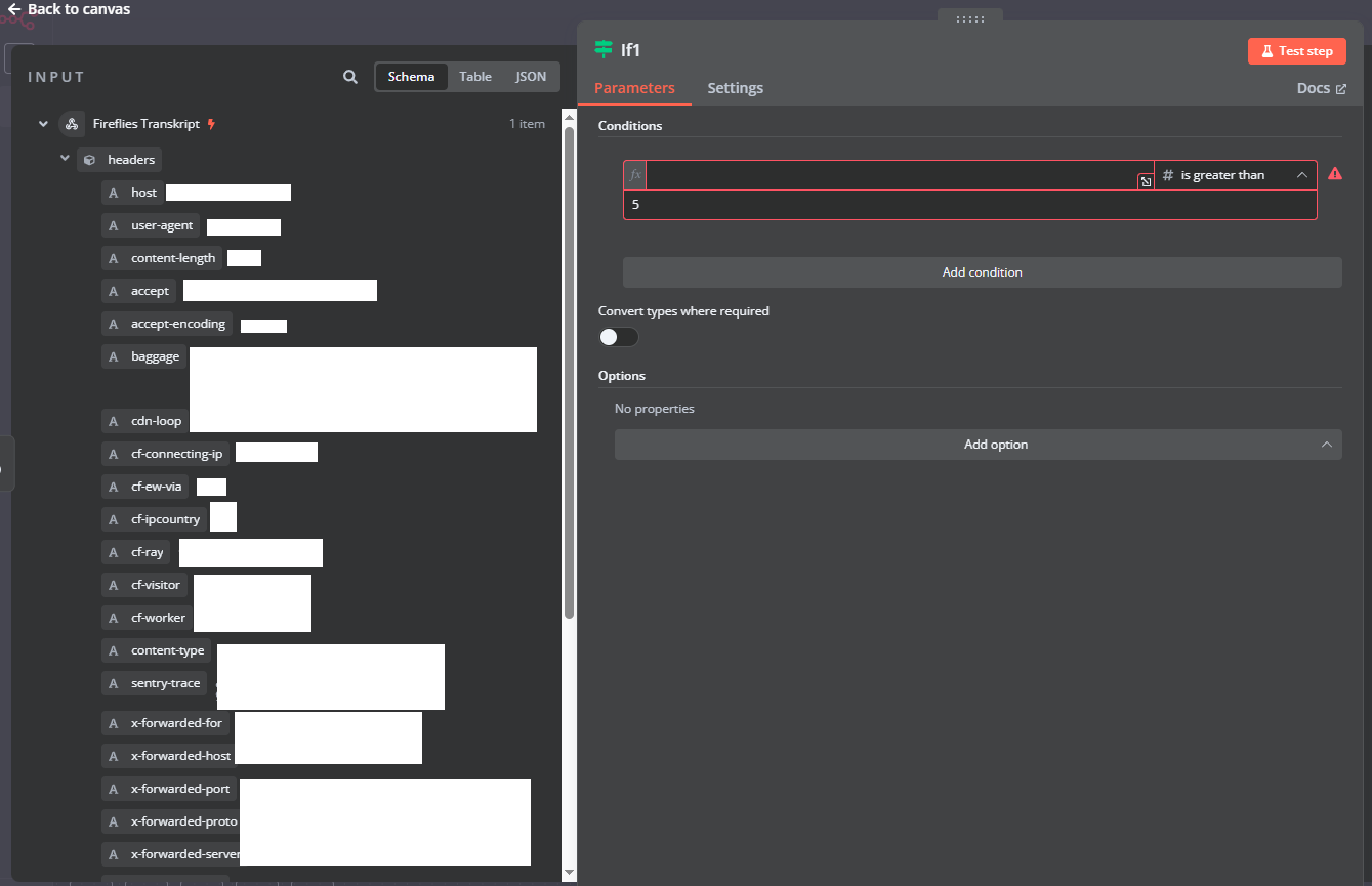

I’d like to end the workflow if the Fireflies meeting is under 5 minutes. But I can’t find a time value in the input, and no setting in Fireflies to pass the duration. Any idea how to solve this?
Thanks a lot in advance!
If there’s no other way, you can get the sentences from the transcript. Each sentence should have a start time and an end time.
The total duration should be approximately the last sentence’s end-time minus the first sentence’s start-time.

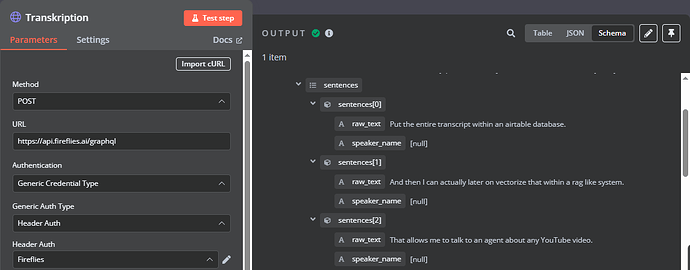

When transcribing with Fireflies, I get sentence blocks, but how can I add timestamps to calculate the total duration?
Do you have a tip for that?
