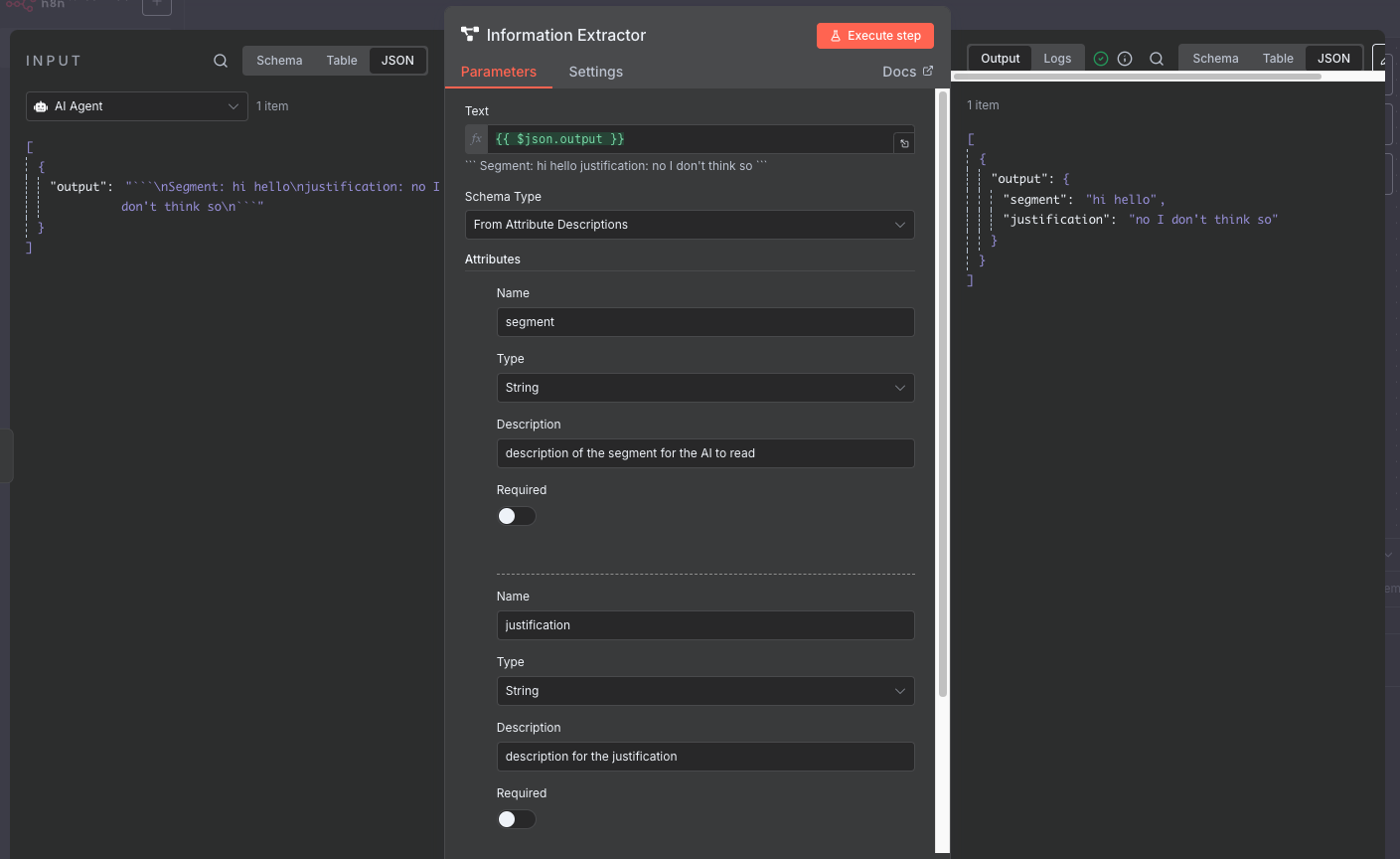

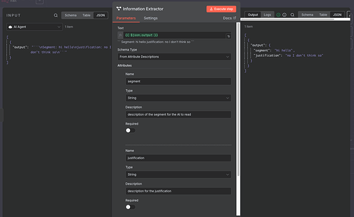

Well there are many ways to structure the output of the agent afterwards. N8N has a built-in AI node specifically for this type of cases. '‘Information Extractor’’ lets you extract certain parts of a text message and form a JSON response and it’s AI based but very robust – fits your case (refer to image for reference).
However, you can still simplify the system message given to the agent and attach a code node afterwards with this code (example of a code piece – haven’t tested it yet);

Here is the node by itself (change the descriptions to fit your case):
