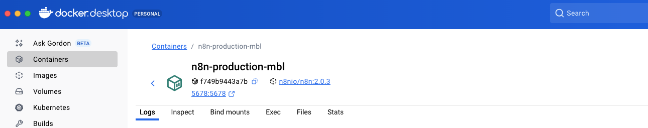

Use of Version 2.0.3 works fine, don´t update until you realy need it. :slightly_smiling_face:
