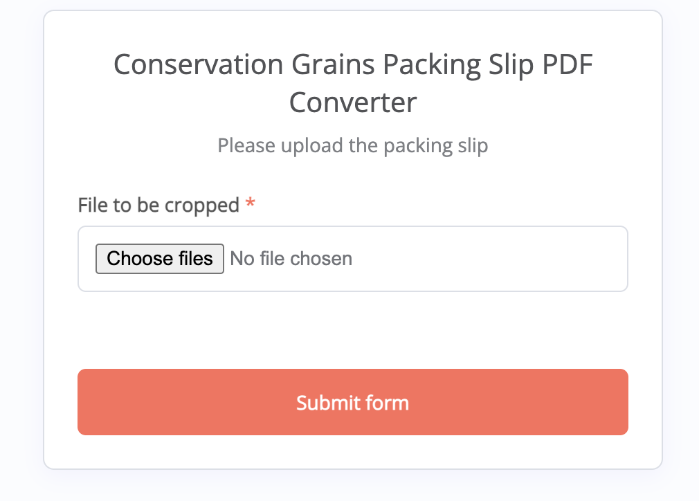

I created a workflow to take PDFs via Form Trigger, pass it to an HTTP that would use my locally hosted Sterling-PDF instance to crop, and then rotate the PDF to my specs, and finally upload the cropped and rotated PDFs to Dropbox. It worked great, I tested it a bunch - worked great - and then it just stopped working. It is broken specifically at the HTTP node. Neither of them work. I rolled up a new n8n instance on another local machine and it works like I had tested it earlier - both HTTP node accept the binary/PDF and change and then pass it through to the next node.

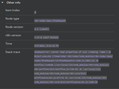

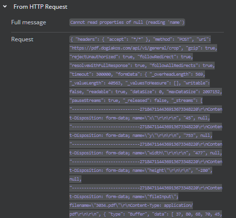

Here are the errors I get from the HTTP nodes:
Outputs
From HTTP Request:

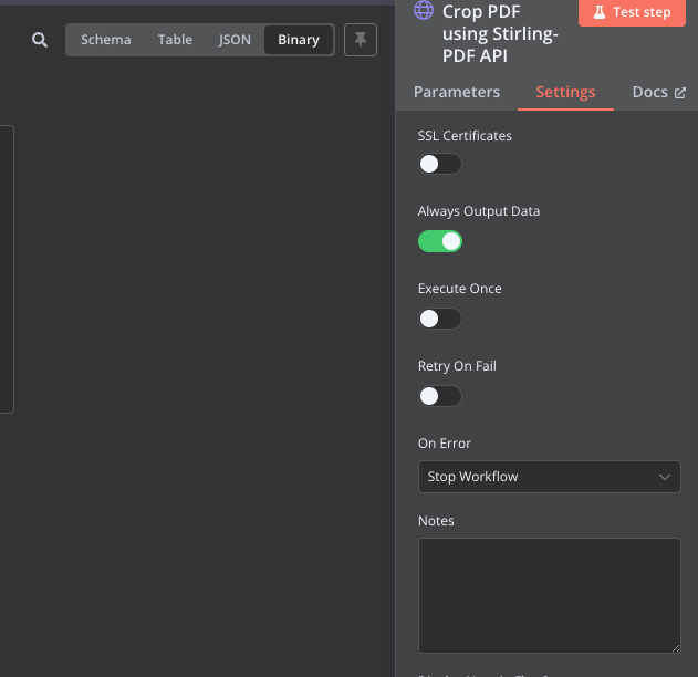

I can’t assure but this could be something to check. I am wondering if you enable the seting Always Output Data and have it displayed if it would bring more insights:

2024-09-10T02:33:41.453315979Z NodeApiError: Cannot read properties of null (reading 'name')
2024-09-10T02:33:41.453348179Z TypeError: Cannot read properties of null (reading 'name')
2024-09-10T02:34:31.545644656Z NodeApiError: Cannot read properties of null (reading 'name')
2024-09-10T02:34:31.545684311Z TypeError: Cannot read properties of null (reading 'name')
2024-09-10T02:42:26.444550047Z NodeApiError: Cannot read properties of null (reading 'name')
2024-09-10T02:42:26.444582434Z TypeError: Cannot read properties of null (reading 'name')
And when I run the work flow from the Production Form Trigger:
2024-09-10T18:19:51.695288327Z NodeApiError: Cannot read properties of null (reading 'name')
2024-09-10T18:19:51.695367994Z TypeError: Cannot read properties of null (reading 'name')
2024-09-10T18:23:18.834745347Z NodeApiError: Cannot read properties of null (reading 'name')
2024-09-10T18:23:18.834781229Z TypeError: Cannot read properties of null (reading 'name')

I noticed at the bottom of the node parameters that the raw requests can be viewed in the browser’s developer console, so here’s that too if it helps: Pastebin
As noted in my immediate previous response the API appears to be functional based on testing via the docs and that the workflow/nodes work on the other machine, but if you have recommendations to test the API in other ways I am open to trying that!
I toggled the “Always Show Output” toggle, but it didn’t seem to give any different data than when it is turned off, unfortunately.

When I look at your raw request from workflow output - Pastebin.com and then I correlate it with the error Cannot read properties of null (reading ‘name’), it makes me think that the issue comes from the snippet of:
​​_streams: Array(15) [ '----------------------------555876309196284475053240\r\nContent-Disposition: form-data; name="x"\r\n\r\n', "45", null, … ]
My first question is: can you get a similar snippet from a WORKING test and see what is shown in there? Does the null appears? If it does not, then what would cause it to appear? And being it legitimate, why we are getting into the error scenario? Maybe it should be considered when it is not.
As this is a Multipart form data, I am wondering if the null can be related with when a part of the form got to an end? I don’t know the specification in deep to tell for sure.
If we could figure out a way to reproduce this at will then the n8n team may be able to check it further.
I can’t narrow down the root cause of the issue, but I hope we can discuss towards it.
