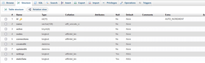

From phpMyAdmin can you check if the workflow_entity table was created with the correct auto increment setting for the ID field? This is something n8n should do by default but it seems to be causing the error on your instance.

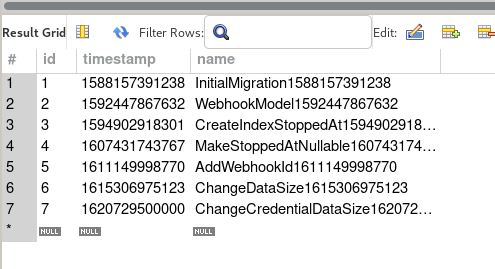

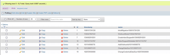

Also can you check the migrations table contains rows? Mine looks like this:
Screenshot from 2021-05-21 11-29-40

workflow_entity has AUTO_INCREMENT:
migrations table looks like yours:
