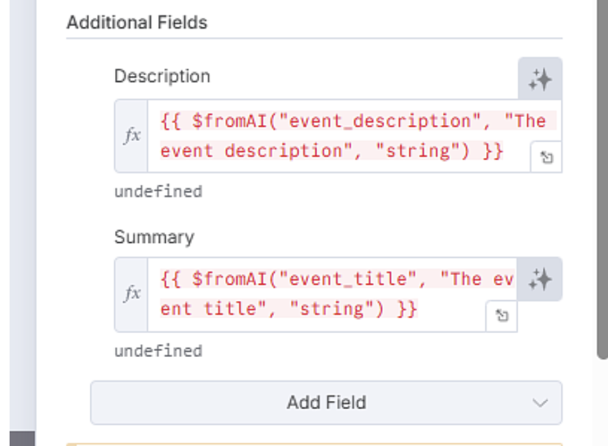

The $fromAI() function used to work, but the past week it stops working (as you can see in the picture below), is it a bug in n8n? Would appreciate if anyone can tell if they face the same issue?

Did you test it? It may show [undefined] when there is no execution data – but it will be filled on execution.
This is before execution:
And here is the same parameter after execution:

No, it still stays red (marked as undefined), but I noticed that the LLM actually generates the summary and the description, so the function works, but the field is still marked in red. Maybe it’s a bug in n8n?
Also, for context, the Google Calendar node is connected to an MCP server

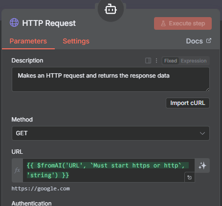

I understand, the fields(containing expressions) are connected to MCP Server Trigger. Usually tools in n8n, or sub-nodes in general, must be connected to an AI Agent for the expression to turn green. The UI doesn’t recognize the MCP trigger as an agent, so it shows [undefined]. But the agent(connected to the MCP) recognizes the $fromAI function in the backend. I suppose it shouldn’t be an issue, though.

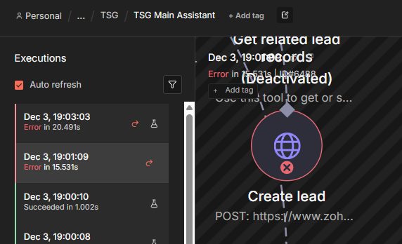

I’m getting this issue as well.

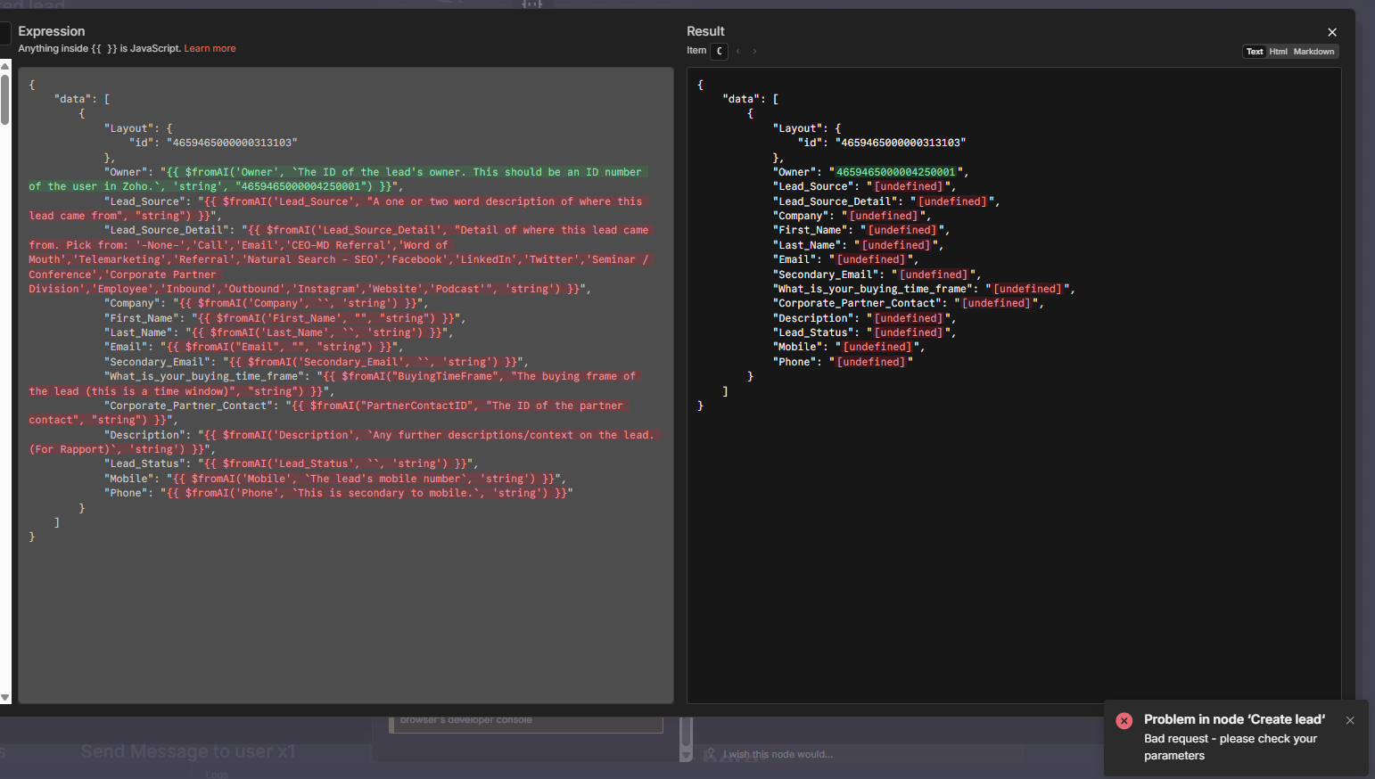

In my execution, it shows as red, and I get this error (using Zoho API)
400 - “{“data”:[{“code”:“MANDATORY_NOT_FOUND”,“details”:{“api_name”:“Last_Name”,“json_path”:“$.data[0].Last_Name”},“message”:“required field not found”,“status”:“error”}]}”
Would love some help with this
