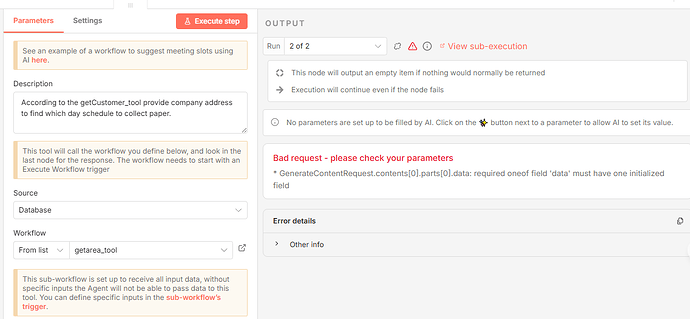

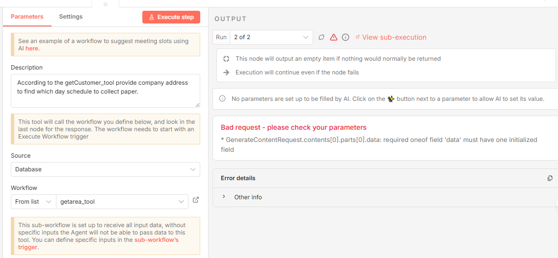

GenerateContentRequest.contents[0].parts[0].data: required oneof field 'data' error for subworkflow
my receive gmail email workflow show the error.
* GenerateContentRequest.contents[0].parts[0].data: required oneof field ‘data’ must have one initialized field

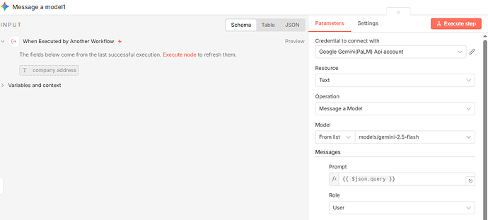

this is my sub workflow. i tried choose “accept all data“ or “define using fields below“. it still show this error. i input some data to test the workflow is no error show.

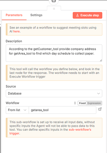

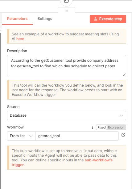

main workflow

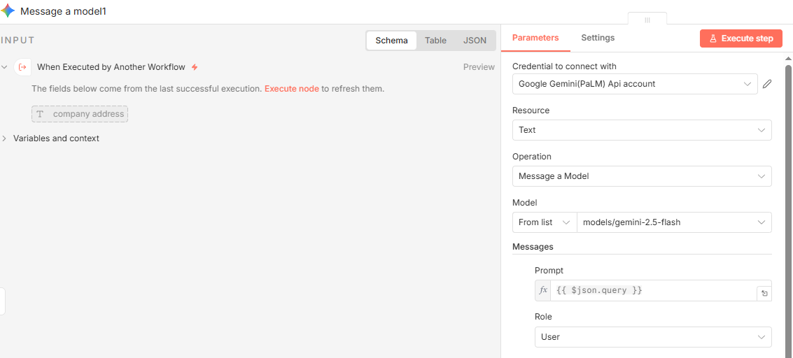

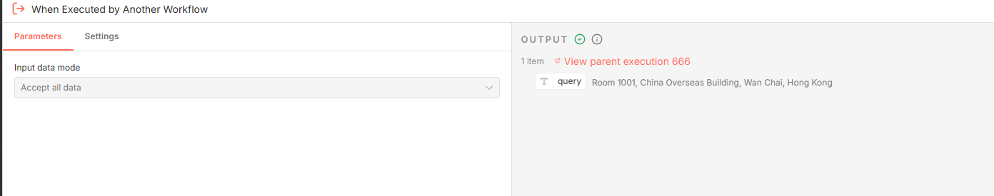

i define input data name is query in when execute by another workflow node.

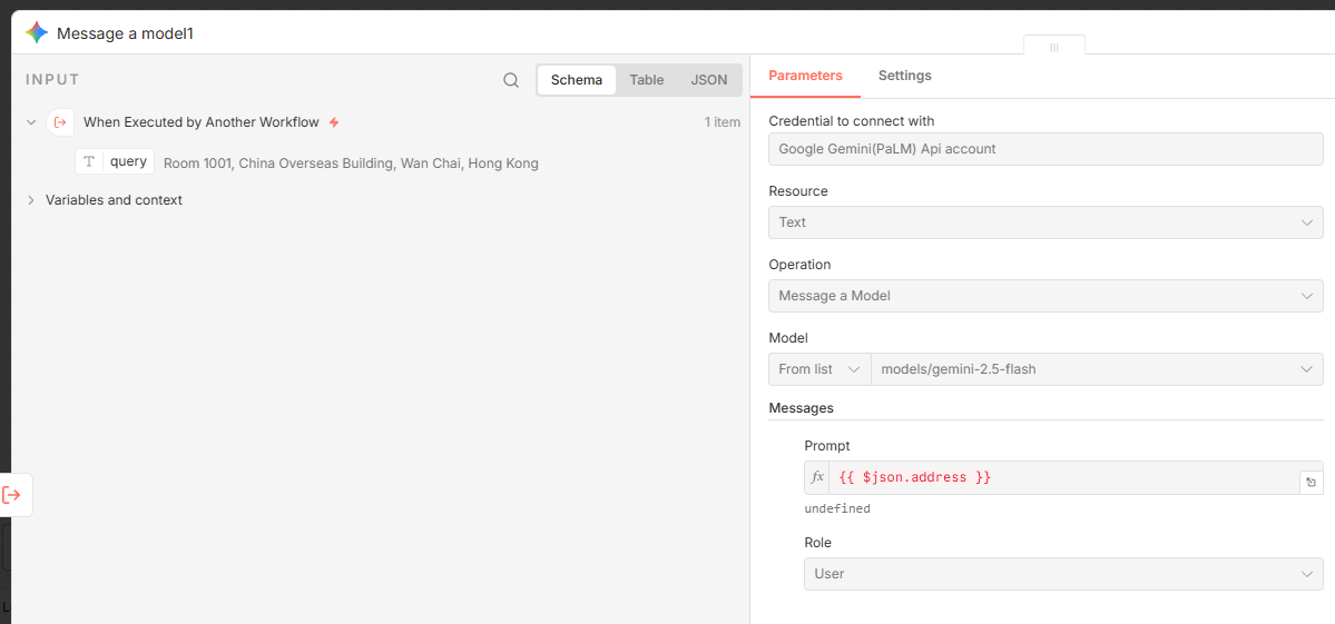

in message a model 1, user prompt message is {{ json.address }}, but i see my workflow is {{ json.query }}

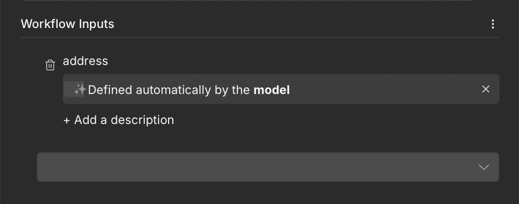

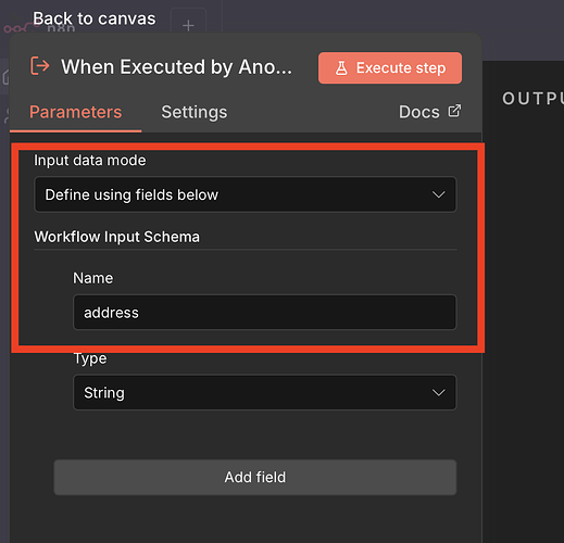

Yes this is because by default, the main AI Agent will send a “query” param to the sub-workflow. You can change this though if you define the input params on the sub flow like this:

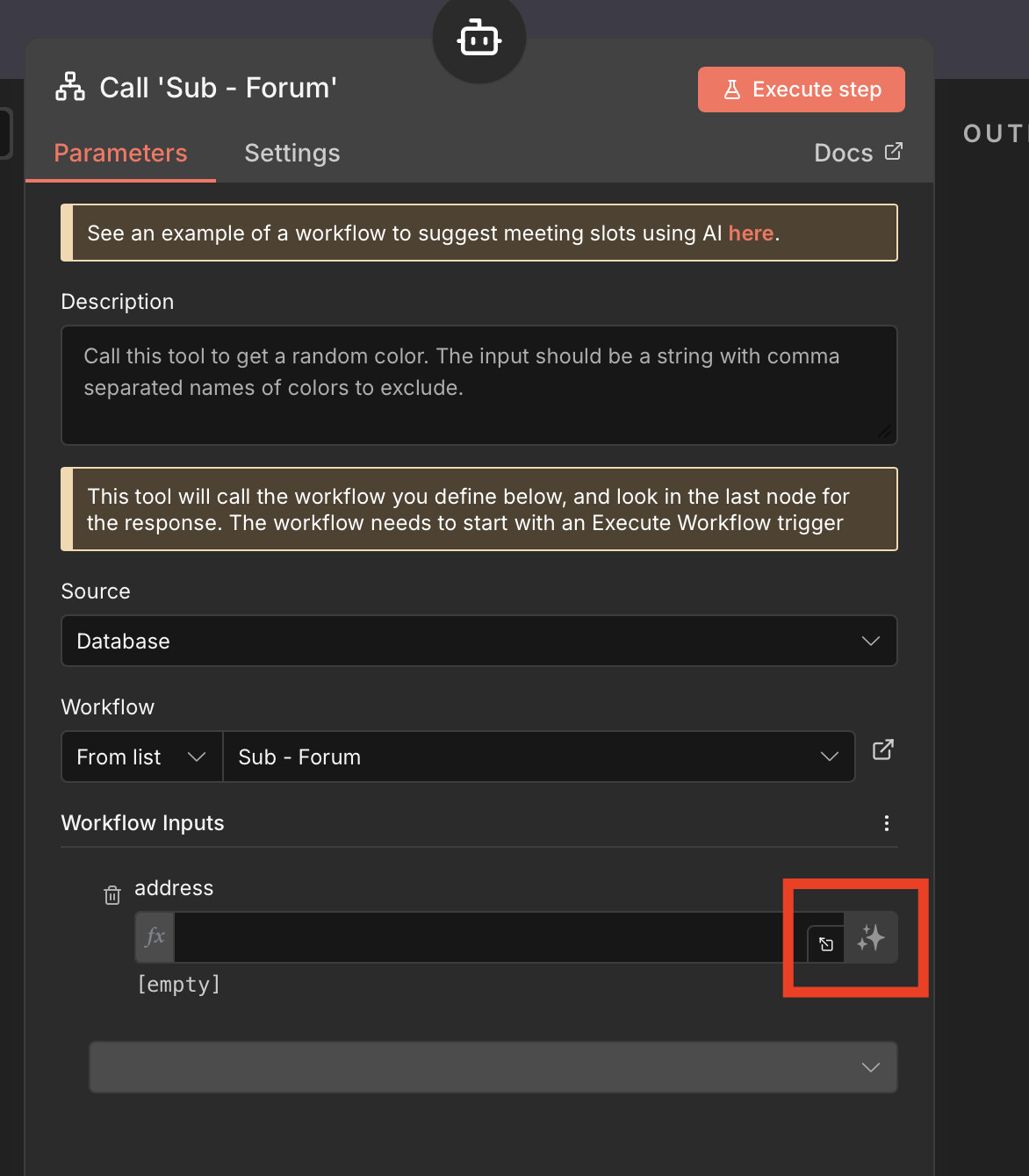

Then in the main flow click the magic button to have the agent fill the filed for you.
it is no show star button to show “workflow input“ data
As per my previous post, on the sub-workflow, make sure you set the property like below. Only then will the option to set the address appear in the main workflow agent with the magic button
