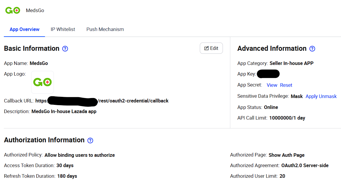

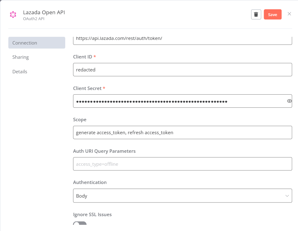

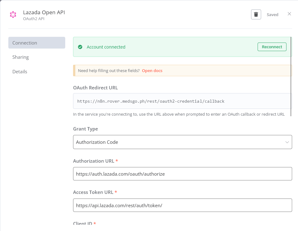

Hey @EmeraldHerald , see the screenshots
Basically I tried changing options in any possible way. But anyway I’m pretty sure that’s it something in the credentials configuration, since I was able to make it work manually.

When configuring credentials, it shows that account is connected, but that’s it. When trying to make a request to API there’s always this error.
Though I just noticed that when configuring credentials you can only select to send credentials either in body or as Basic Auth. While manually I did it as query parameters. Could it be the reason?

The issue here will be that they use 3 different urls for tokens and we only support 2 so the token will never be refreshed.
Other than the refresh failing though the Access Token URL should be:
https://api.lazada.com/rest/auth/token/create
Hey @Jon , even if I use https://api.lazada.com/rest/auth/token/create I still get the same error
Hey @Alex_Goryainov,
Sadly I would expect this to fail at some point as they use 3 URLs although I would have expected using the create would have done the trick until it expired. I have tried to set up a trial account to take a proper look but it doesn’t appear to be the easiest thing to get a trial of.
