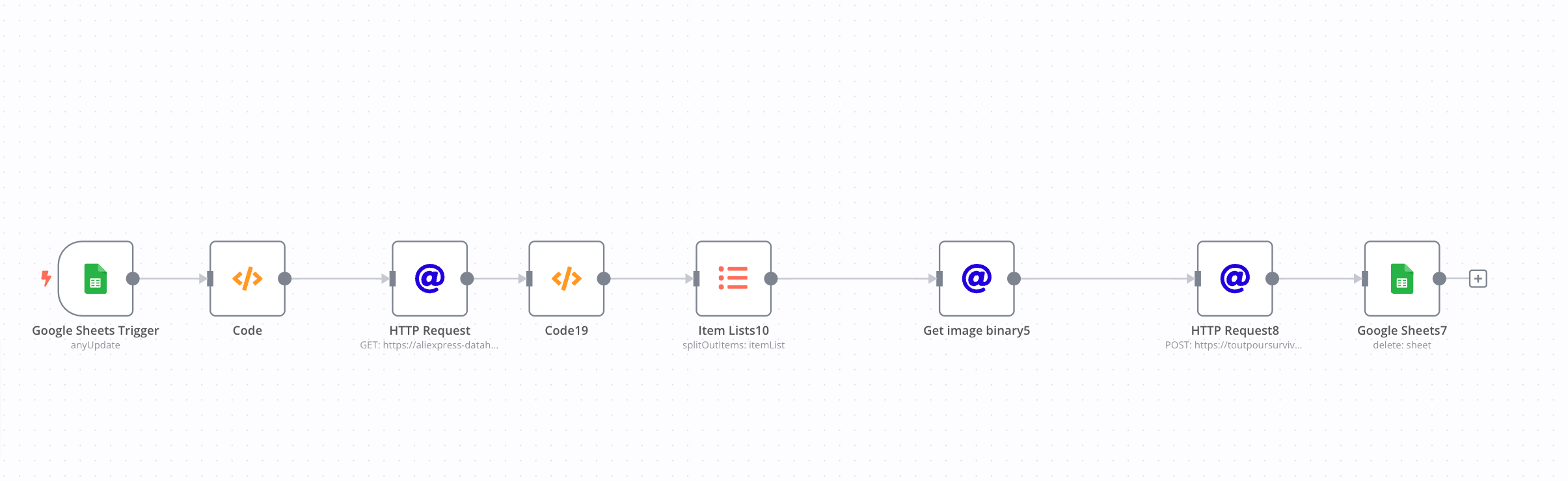

Hi everyone,
The "Get image binary5 " node does not execute when the workflow is automatically activated ( when triggered by updating or adding a row on google sheets), but works perfectly when it’s activated with the button “Execute workflow”.
By “working perfectly” I mean being executed,
I really don’t get why when I press the “execute workflow” button it works perfectly, but if it’s triggered, the node is just being skipped ?
  • n8n version: 1.4.1
  • Running n8n via Docker
Hi @Louis_Murie :wave: Is this also happening to you on 1.8.2? When the node doesn’t run, is `{{json.links}} populated?
If those don’t sort it out, would you also be able to share your workflow’s code by copying and pasting it over here? You can do that by hitting ctrl/cmd + a then ctrl/cmd + c on the workflow editor, and pasting the result over here between two sets of three backticks (```).
