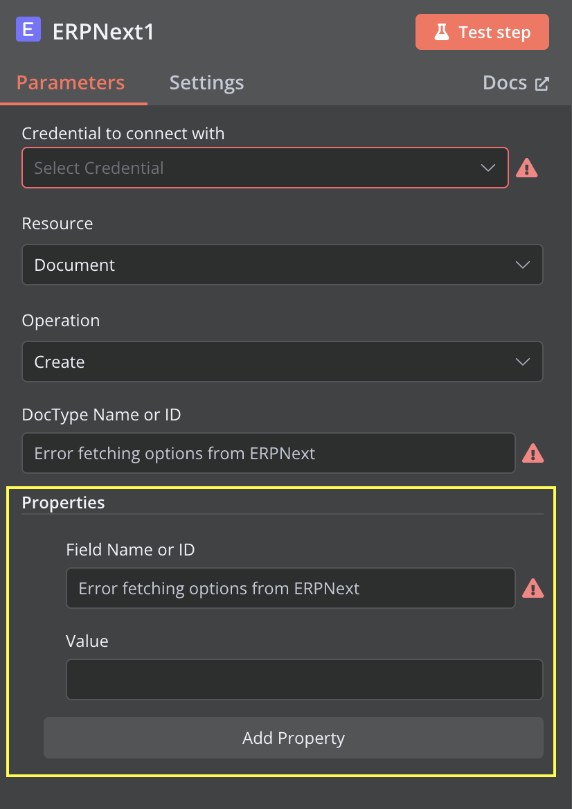

I think you can get by without Code node and you need to map the values between GSheet data and ERP by adding the Properties in the latter.
Turns out I was overthinking things and that’s really all I needed to do. Thanks for answering!
