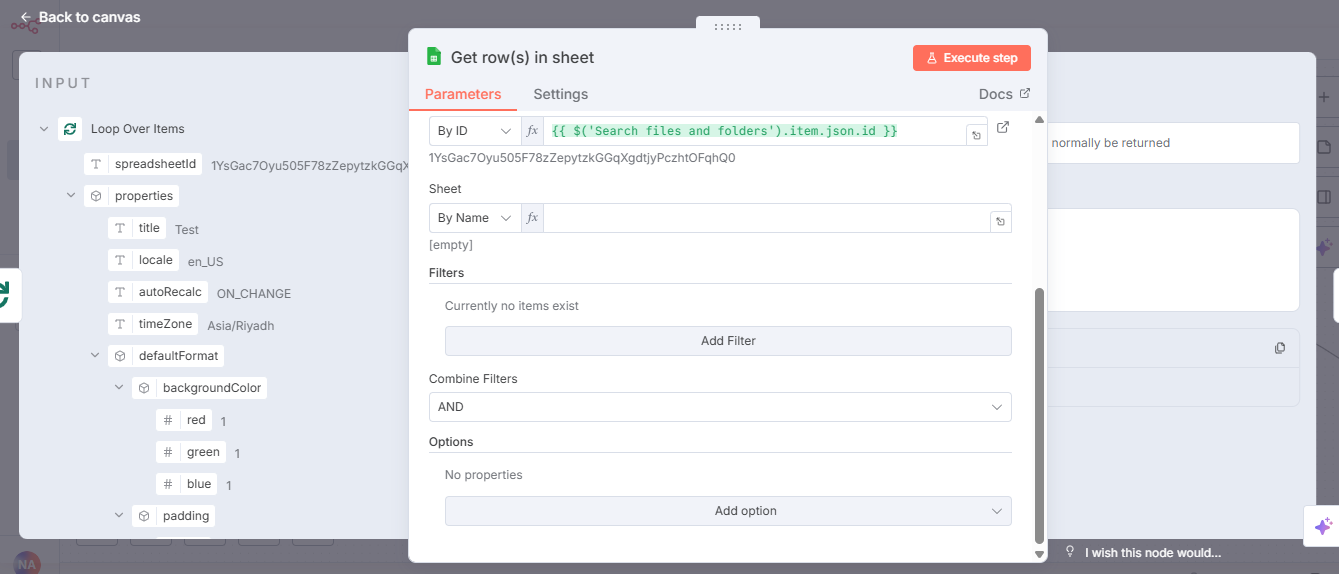

Hey I am trying to bulid a workflow that allow me to get info from my googlesheet , It is working but the only prpoblem that i cant solve is how to let it read all sheets inside every Gsheet . Is there any soloution ?
  • n8n version: 1.113.3

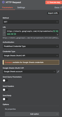

You can use an HTTP Request node to get all the sheet information using this endpoint:
https://sheets.googleapis.com/v4/spreadsheets/YOUR_SPREADSHEET_ID
Don’t worry — just use the same Google Sheets credentials you already have.
Here’s a simple demo workflow to get you started:
