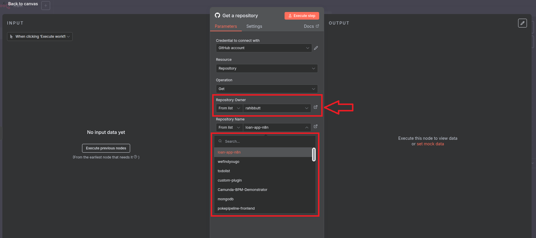

I am trying to integrate my GitHub account to n8n. Error is, that i am not getting a list of repository owners, or any output if i try and “get all” repos.

Hi @MikkelLehm
You need to type your Github username inside “Repository Owner” search field and then select it in order to fetch all the repositories from your Github account.
I have tested the Github node on my end:
Hope this answers your question. :slight_smile:
Thank you so much!
Works like a charm. Didnt register you had to type it manually, i just expected it would appear in the dropdown
