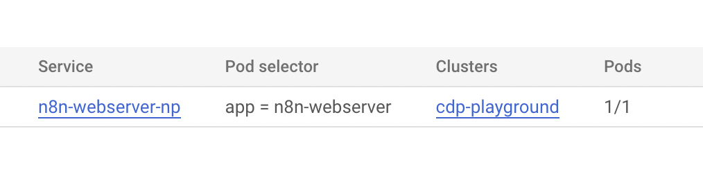

What we are doing is pretty simple, we follow tour guide and end up with this terraform definitions:
resource “google_compute_global_address” “default” {
name = “n8n-playground-ip”
resource “google_dns_record_set” “n8n” {
name = “n8n.my-domain.dev.”
type = “A”
ttl = 300
managed_zone = “my-domain-dev” #This exists an its ok
rrdatas = [google_compute_global_address.default.address]
resource “kubernetes_service_v1” “node_port” {
metadata {
labels = {
name = “n8n-webserver-np”
spec {
selector = {
app = “n8n-webserver”
port {
port = 5678
target_port = 5678
name = “web”
type = “NodePort”
resource “kubernetes_deployment” “n8n_webserver” {
metadata {
name = “n8n-webserver”
labels = {
spec {
replicas = 1
selector {
  match_labels = {
    app = "n8n-webserver"
template {
  metadata {
    labels = {
  spec {
    container {
      image = "n8nio/n8n:1.12.0"
      name  = "n8n-webserver"
      port {
        container_port = 5678
      env {
        name  = "N8N_PORT"
        value = "5678"
      env {
        name  = "N8N_PROTOCOL"
        value = "http"
      env {
        name  = "NODE_ENV"
        value = "production"
      env {
        name  = "N8N_ENCRYPTION_KEY"
        value = "---"
      env {
        name  = "DB_TYPE"
        value = "postgresdb"
      env {
        name  = "DB_POSTGRESDB_HOST"
        value = "emapper-db-np.default.svc.cluster.local" #This exists an its ok
      env {
        name  = "DB_POSTGRESDB_PORT"
        value = "5432"
      env {
        name  = "DB_POSTGRESDB_USER"
        value = "---"
      env {
        name  = "DB_POSTGRESDB_PASSWORD"
        value = "---"
      env {
        name  = "DB_POSTGRESDB_SCHEMA"
        value = "n8n"
      readiness_probe {
        http_get {
          path = "/"
          port = 5678
        initial_delay_seconds = 10
        period_seconds = 5
Until here everithing is ok and if we create a default Load Balancer, every runs pretty well.
But enter the Infamous INGRESS:
resource “kubernetes_ingress_v1” “n8n_ingress” {
depends_on = [kubernetes_service_v1.node_port, google_compute_global_address.default]
metadata {
name = “n8n-ingress”
annotations = {
  "kubernetes.io/ingress.global-static-ip-name" = google_compute_global_address.default.name
  "kubernetes.io/ingress.allow-http": true
  "kubernetes.io/ingress.class": "gce"
spec {
default_backend {
  service {
    name = kubernetes_service_v1.node_port.metadata[0].name
    port {
      number = 5678

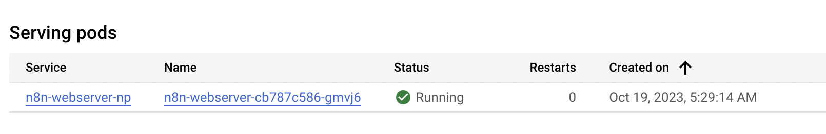

And it does not work:
The instance group is OK, i can access the webserver using curl from other pods, and by the simple load balancer from outside… etc…
But through the ingress NOPE, since it never go up !!
Hope you can help us.
Thnaks.
