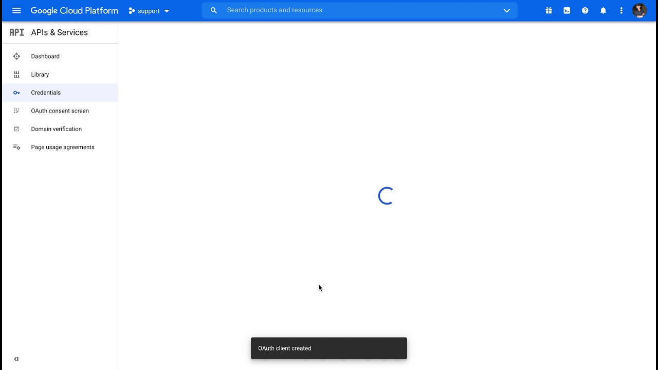

I cannot solve problem with adding credentials in n8n to gmail node. I followed this tutorial (instead of Google Sheets API, I’ve done it with Gmail API):
But when I get to the moment in this video on 2:08 I get this error:
How to pass this? Someone had the same problem?
