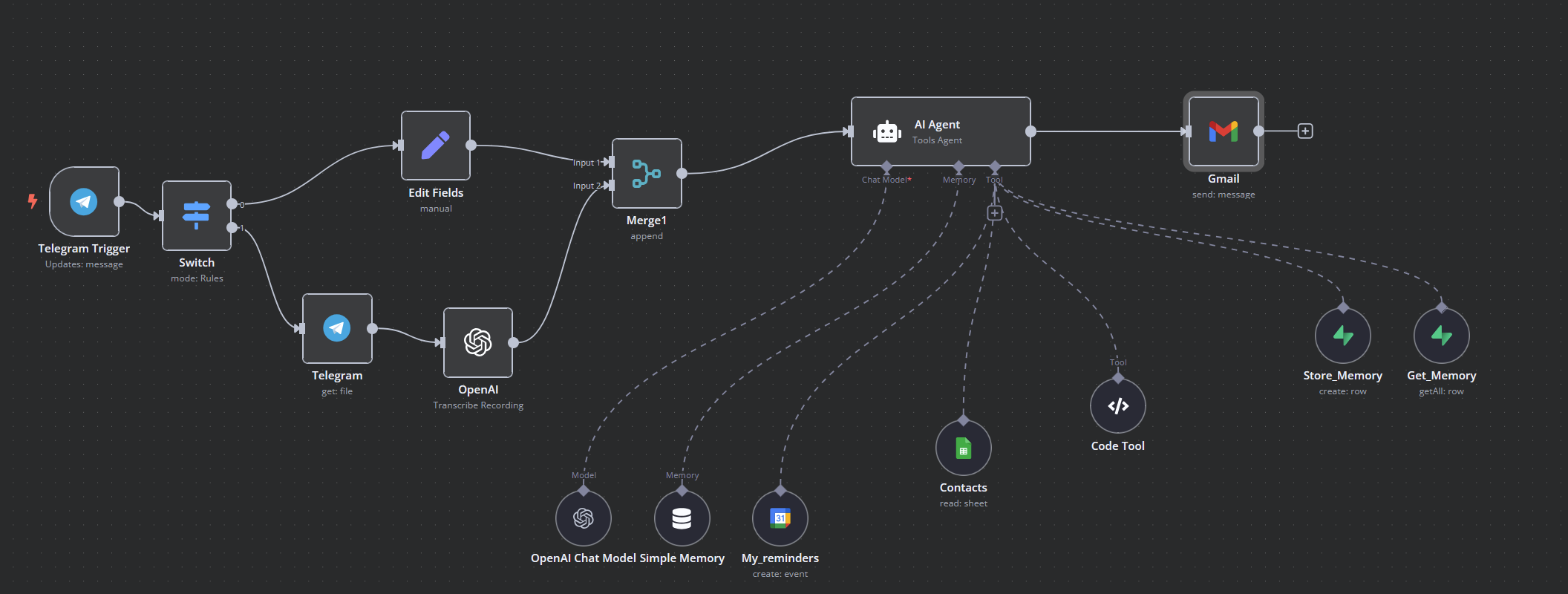

Hey,
Here is my workflow :
I have email contacts stored in google sheet tool, now what I want to do is, send a message in telegram saying send an email to Chris, and it will find email of chris with google sheet tool and then send the email for approval on telegram once I approve i want it to send using gmail api but its not working.
Please help.
Hi, can you copy / paste your actual flow instead of a screenshot.thanks
Actually my workflow seems to be wrong , here is what I want to do :
telegram will be my trigger, so when I ask telegram to send email to chris, the agi agent must find the email from contact tools which uses google sheet, and then create the email but before sending, I want it to get it approved via telegram and then it sends the email once I approve in telgram, how can i create such workflow, that means sending email wont be a tool , send gmail email will be after the telegram approval message, how can i create such workflow?

I will try but my question is I want to use human in the look with telegram before sending the email but thats only possible if i use the gmail node after ai agent, but if I use gmail as a tool its directly sending email before it reaches for approval on telegram
Well most automations are possible, but it doesn’t necessarily mean the node would exist. Let’s assume that someone would create an approval tool which can be used by ai. Approuvera in a dB.
Tool prompt. Tool providing approval by sending mail to approver etc with link. After thank link to webhook… System prompt on ai. Before sending mail you need to get approval. I just want to say many things are possible. But it’s like programming there is not 1 definitive answer to your question
