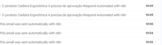

This problem started today; yesterday the sending was normal, for each execution of the weebhook trigger I received an email. I tried changing the response to “immediately” and that made it go back to sending only one email for a while, but soon after it went back to sending two.

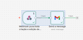

I didn’t test it with an Imap node, but I tested it with an email sending node, and the behavior remains

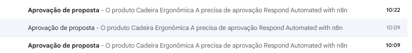

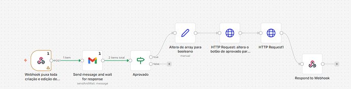

For reasons beyond my knowledge, adding the “wait” node worked for sending emails, but when replacing it again with the send message node and waiting for a response, it immediately sent 2 emails to be executed:

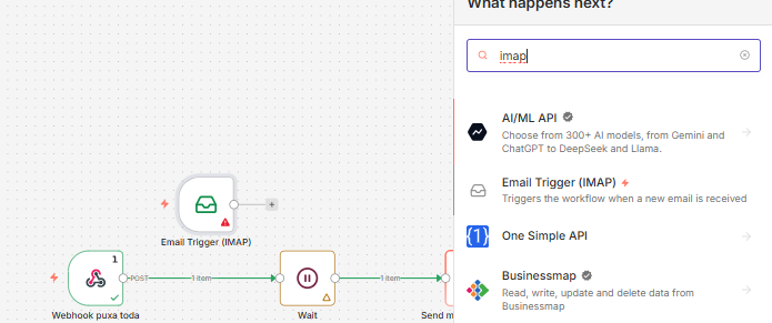

Regarding the use of the IMAP node, would it be the trigger when receiving emails or a community node? It’s my first time using the tool, so I still have a lot to learn

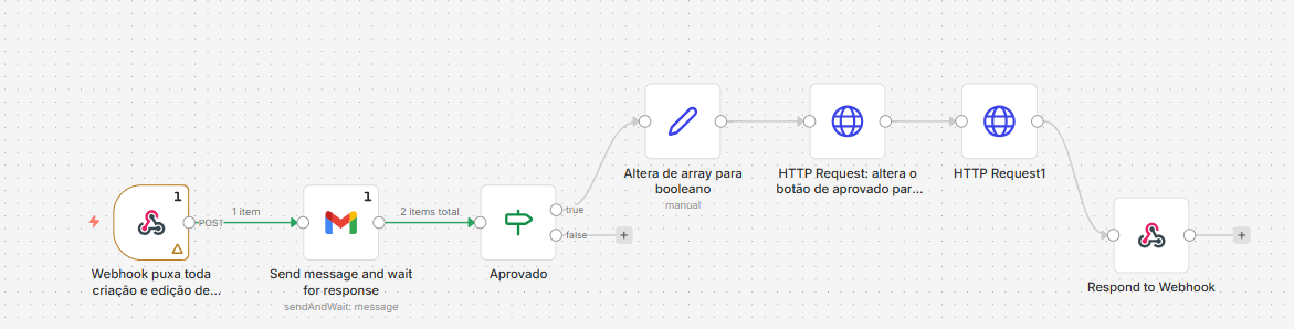

I decided to test again and now only 1 email was sent, I made zero changes:
I Guess wait node is our fix!
And for IMAP it is for triggers and for our use case SMTP :
