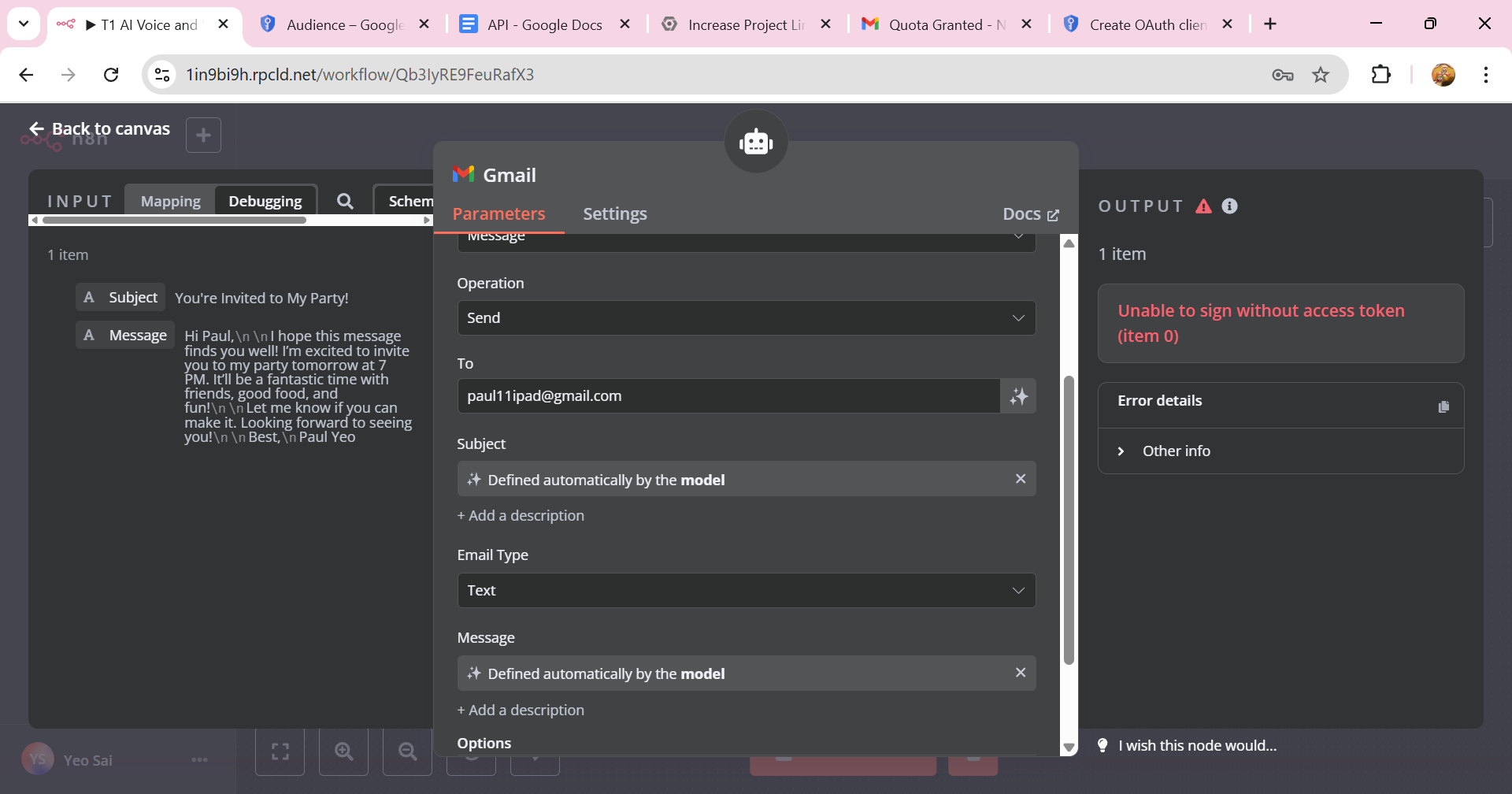

When i instruct AI to send a email , i alway get below error msg .
Unable to sign without access token (item 0)
My gmail parameter as below :
Below are thing i did :
I have create email credential. Already enter ID and SK
My credential email project in production. ( Not in testing stage )
Hope some one can share with me where go wrong ?
When i import project in and just add credential it work fine. , it can send email out. but when i try to create project by myself i encounter problem.

Are you sure that you successfully connected your Gmail credentials?
@mohamed3nan Thank you very for your reply, my make it was .
  1. i need to make sure tuen on API to production ( cannot be in testing stage )
  2. i need to ensure that after enter secert key , google icon must appear , so i can click in to test the connection,
  3. if error msg , due to API not turn on , i need to turn on , then go to step 2 again. till google connection is successsfully connected.
Paul
ok, so your problem is solved?
Yes thank you @mohamed3nan
