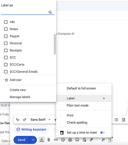

Hey,
I think the issue is, it’s expecting a message to be received with the label already attached, I just tested and it seems if I got the email to inbox then I add the label, it doesn’t process, it only processes when I send an email with the label attached already, then it processes.
Like this, if I send email with label attached, it works. Maybe you need a workflow to forward / reply to the email but send it to yourself with a label, so the workflow will pick it up then, so have another workflow which forwards email to yourself and adds a label maybe, not just add label.
Hope that helps,
