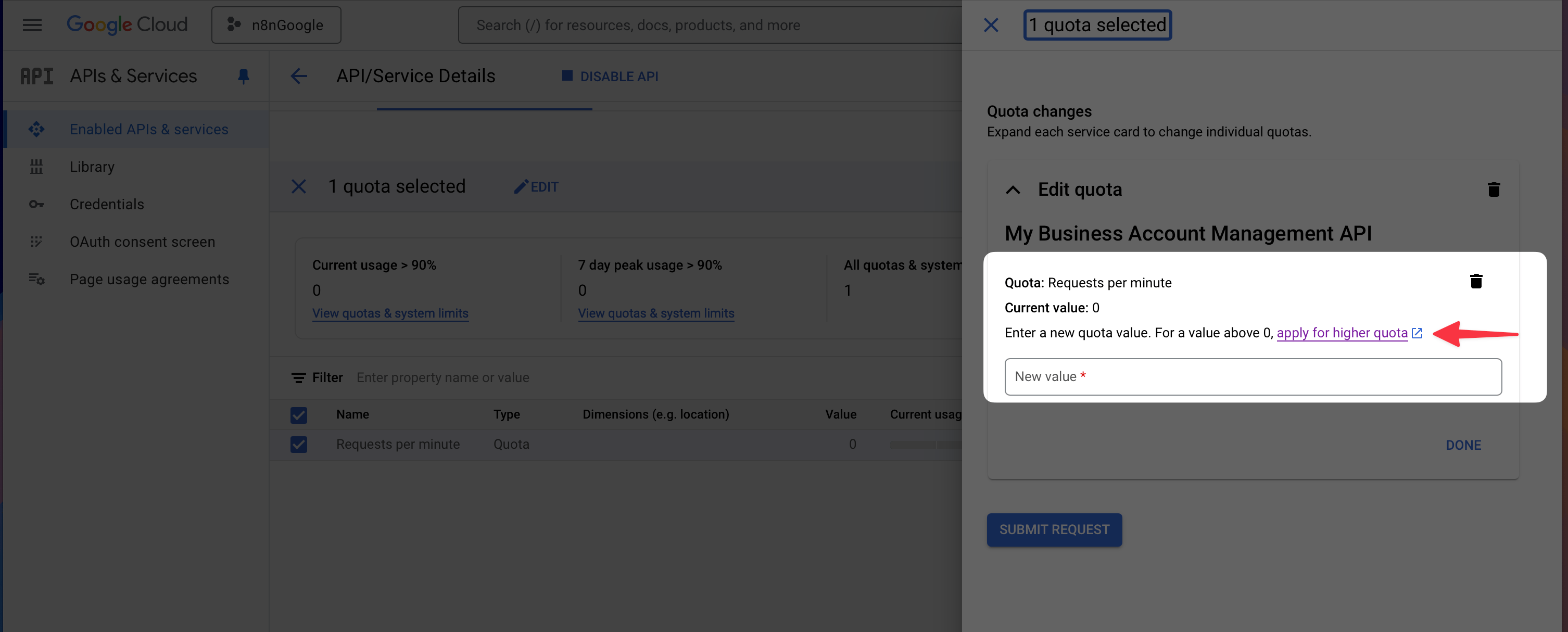

Alright I think I figured out.
As I’m using a free version of n8n I don’t have access to the logs so instead of using the native GBP node available on n8n, I attempt to make a direct GET request instead to test the API and get more visibility on the issue.
It appears that new Google Cloud projects have a quota of 0 on most API and it is at first not possible to increase such quote. Instead Google request their first time API users to submit a form for basic API access first. Here is the form Google Business Profile API Support - Google Business Profile Help
Note that they will request your project ID and your project number. The project ID is easy to get via the Google Cloud UI but the project number is a bit more difficult to obtain. You’ll need to open a shell on Google Drive (top right corner on the left of the notification bell) and type the command “gcloud projects describe [yourprojectID]”. Replace [yourprojectID] with your actual ID with the brackets. In the result you’ll get your project number.
I believe that once you get approved you’ll be able to use the n8n node for Google Business Profiles. Mine is still pending so I cannot totally confirm this yet but either ways API calls also work for me so I absolutely need API access for GBP anyway.

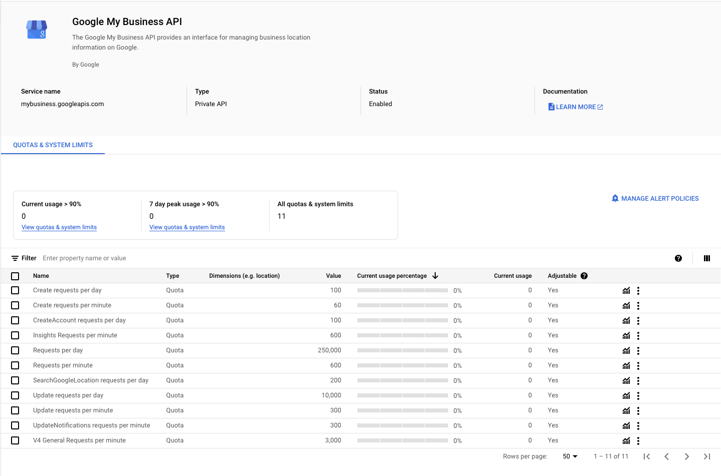

After I reached out to Google I received basic API access for Google My Business API and managed to make this work.
Worth noting that in Google’s reply they specified that they will only give such API access for one project per company so I will not get GBP API access for the another Google Cloud Project even if I wanted to. That’s something to consider when you have to decide which project ID you want the API access to be assigned to.
