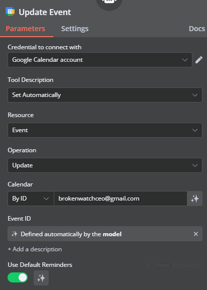

I’m trying to understand the issue, is it that you can’t access your calendar?
I had a similar issue before, fixed it by changing the calendar field, to ID and then using the Gmail i logged in with.
Maybe try that?
Thank you for answering,
I’ve checked and it’s already set by ID
not my choice it was automatic (AI choice, I guess)
I’m posting the complete panel shot screen, just in case it helps to understand the issue.
Thanks Again!
Screenshots of the GCalendar panel
Just in case it helps to figure things out…
I’ve resolved that issue the following way:
  • in the Calendar node
  • went to the Calendar field
  • Selected from list from where I’ve
  • Selected the Gmail Calendar I wanted to use.
So I guess that depending on some other settings (that I have no idea about) it’s either selection by ID like BrokenWatchCEO proposed or by List… I mean, try the one that you haven’t yet to see if it works.
