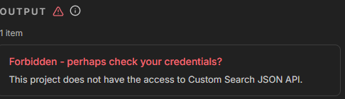

I am having trouble setting up Google Custom Search. It keep returning this error:
Forbidden - perhaps check your credentials?
This project does not have the access to Custom Search JSON API.
I have restricted my key but it still returns same error

I used to use this API some time ago, but after testing it again now, it’s indeed no longer working:

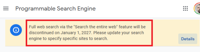

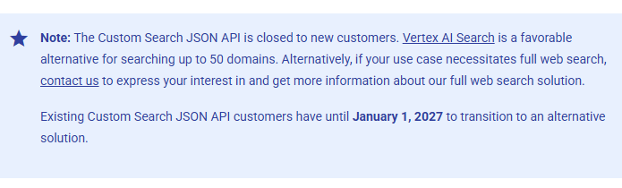

and after spending some time investigating, I found that Google mentioned this API will be discontinued in 2027:
The weird thing is that it still works via the APIs Explorer on their docs page (the panel on the right)!
So in theory, you could copy the request along with its headers and parameters and try to replicate it, I haven’t tried that myself, though..
That said, since it’s going to be discontinued anyway, it looks like Google has already started restricting access for users..
My advice: save yourself the headache and switch to an alternative like SerpAPI, Brave Search API, or any similar service..
