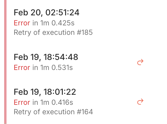

A: Error always occurs at exactly 60s

However, the error in my case is always occurs at exactly 60s, which indicates that may not caused by unstable server or unstable internet connection.
