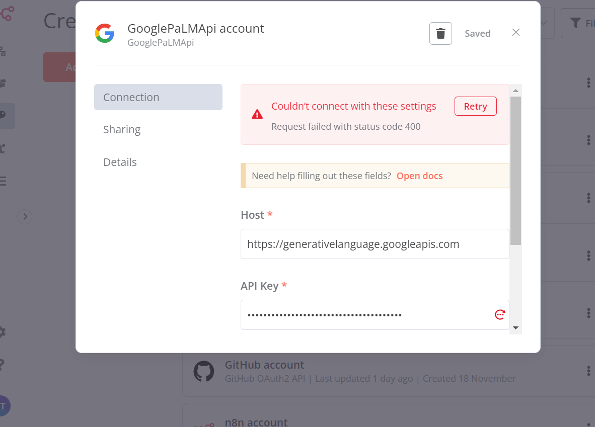

It’s when credentials setup via API
As for the error, I suspected Google Palm API is restricting some regions from accessing it: vps - How to Resolve "User Location Not Supported" Error When Connecting to palm2 API from Server in Amsterdam? - Stack Overflow
Hence, I tried to authenticate my Google Palm API via curl, but it also failed:
curl -H 'Content-Type: application/json' -H "x-goog-api-key: AI            zaSyDQElTIH-A_qBZkYp_1FWU8SqMXCdh9BzM" -d '{"prompt": {text: "Give me five subca            tegories of jazz"} }' "https://generativelanguage.googleapis.com/v1beta3/models/            text-bison-001:generateText"
and shows error code below:
  "error": {
    "code": 400,
    "message": "User location is not supported for the API use.",
    "status": "FAILED_PRECONDITION"
I think I could close this case if this is the case. Thanks a lot.

Hey @TAN_YONG_SHENG,
You are correct there the Palm API is not available from all locations yet which would explain why it is not working for you. A list of available regions can be found here: https://developers.generativeai.google/available_regions
