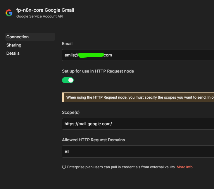

I have the same issue with a service account which has the single scope `https://mail.google.com/\\\`.
After struggling, I’ve tried creating an AppScript (in GCP) and found out that my service account is well confingured with DWD (domain-wide delegation)
I can use the saved credentials in HTTP Request node (able to retrieve email and querying gmail api) , but not with Gmail Trigger nor other Gmail nodes.
Obviously the issue is into n8n nodes and not into credentials itself

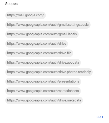

@minshyh16 I set up multiple service accounts for each Google product - Drive, Sheets, Docs, Slides, Calendar, Admin, Gmail.
The problem from begining was scopes. So I found this:
If I understand correctly, n8n checks all these whatever you are trying to do, so for all DWD records I added these + the necessary for the specific product.
https://www.googleapis.com/auth/drive,
https://www.googleapis.com/auth/drive.file,
https://www.googleapis.com/auth/drive.appdata,
https://www.googleapis.com/auth/drive.photos.readonly,
https://www.googleapis.com/auth/presentations,
https://www.googleapis.com/auth/spreadsheets,
https://www.googleapis.com/auth/drive.metadata
Regarding Gmail, from testing, I think the problem is in the Gmail node itself. HTTP node request worked for me.

IF using an HTTP request, you need to add scopes in n8n credentials as well. I add only one:
I did this for a test and I got the results:
GET https://gmail.googleapis.com/gmail/v1/users/{{$json.email}}/messages?maxResults=1
The scopes I used in DWD:
Let me know if this helps!
