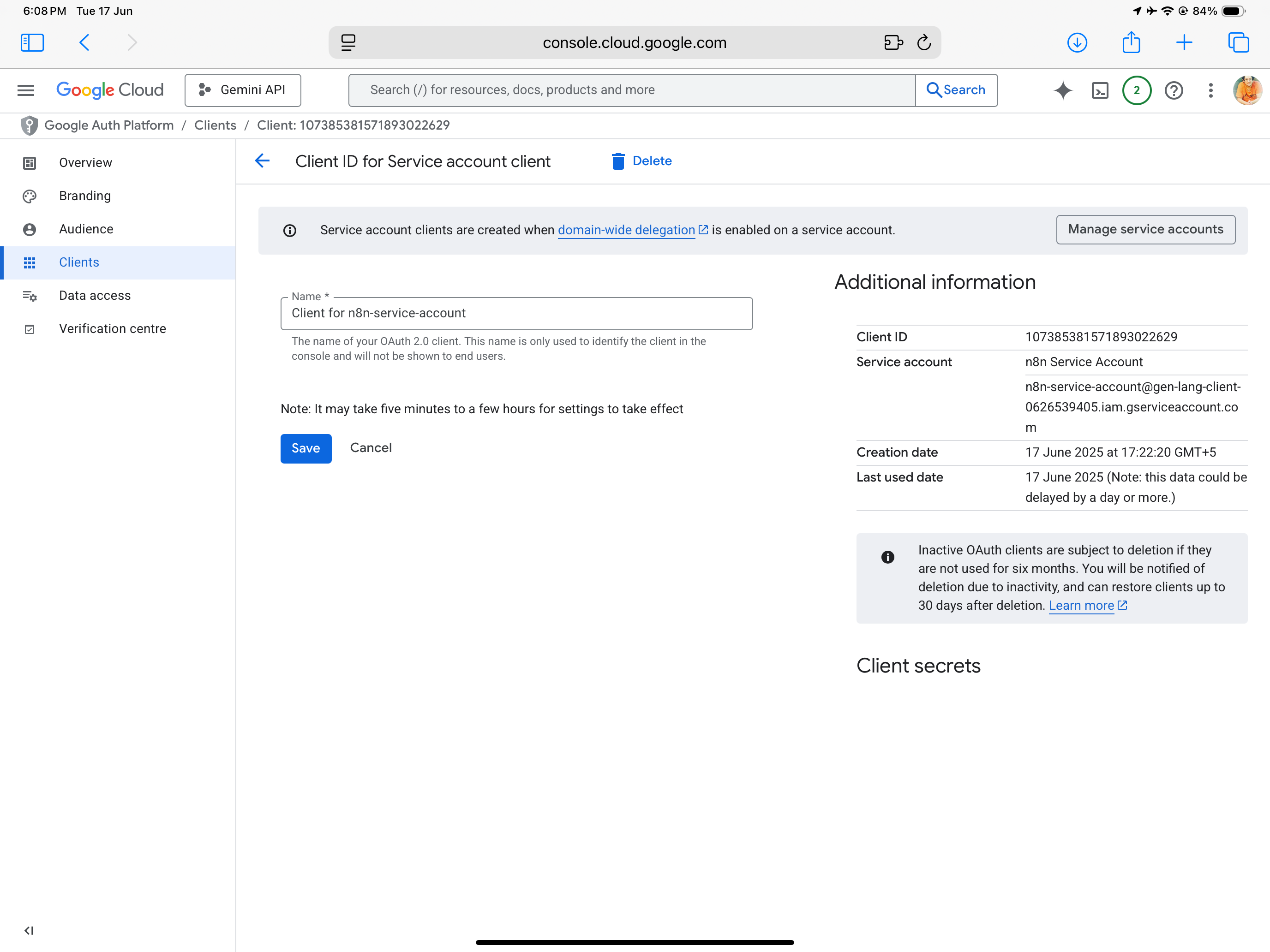

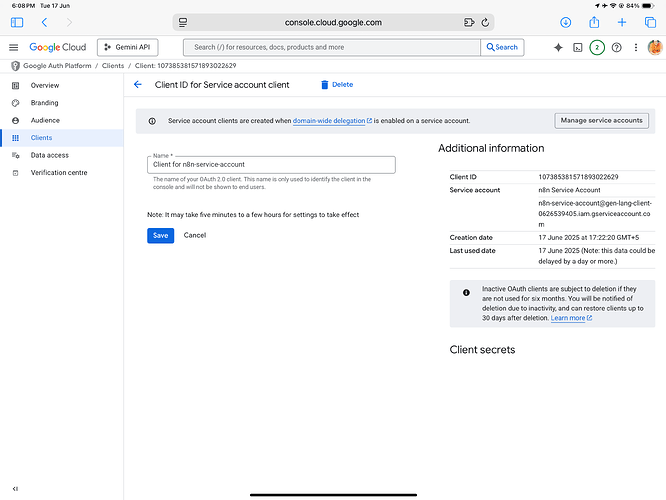

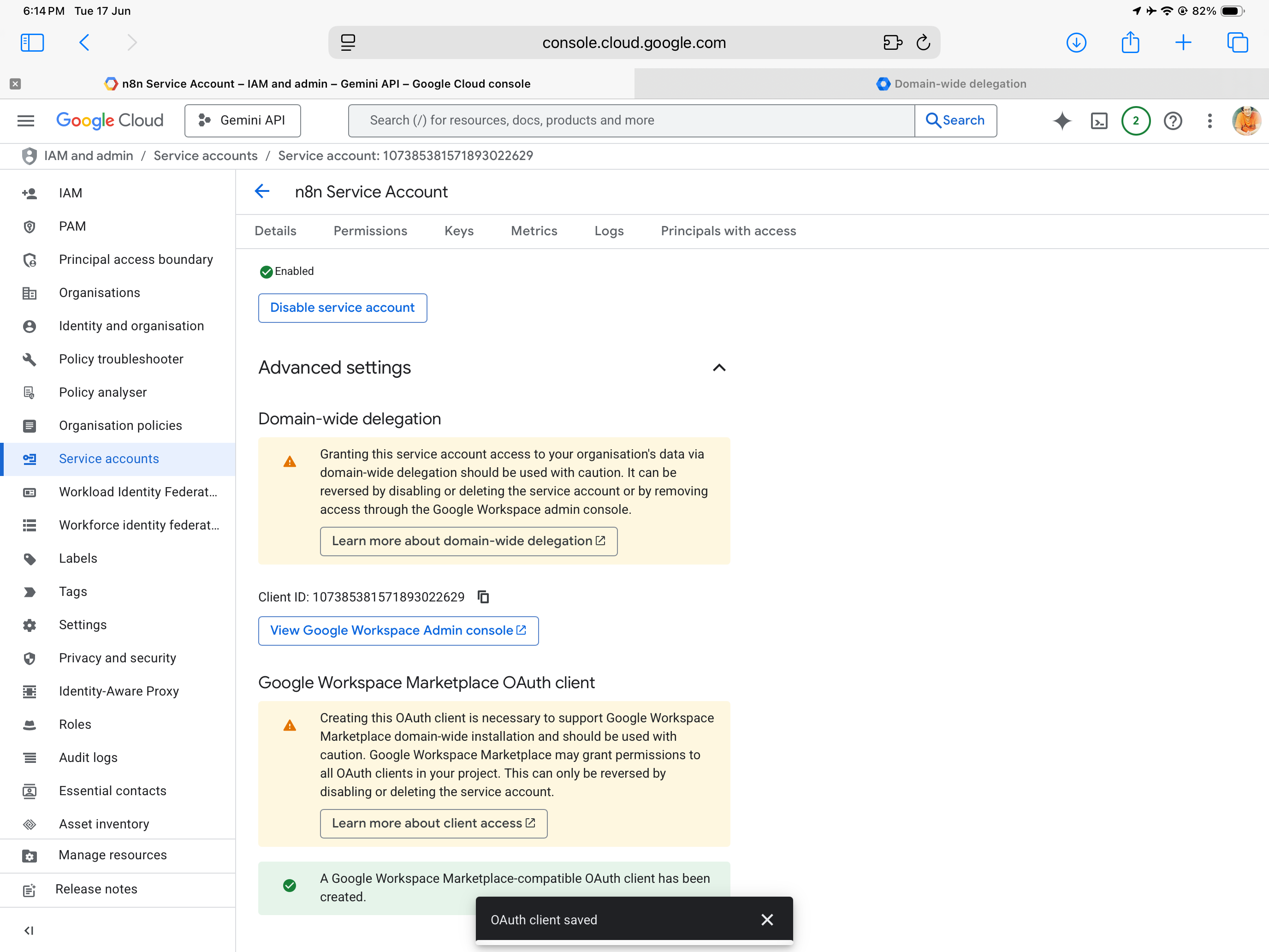

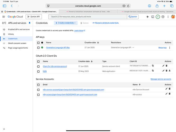

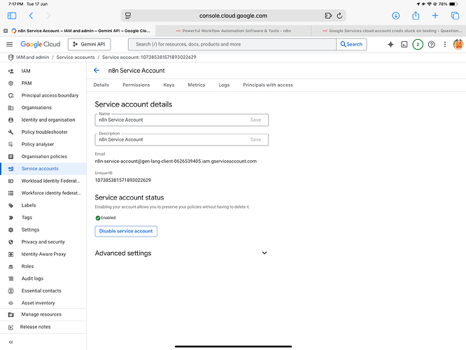

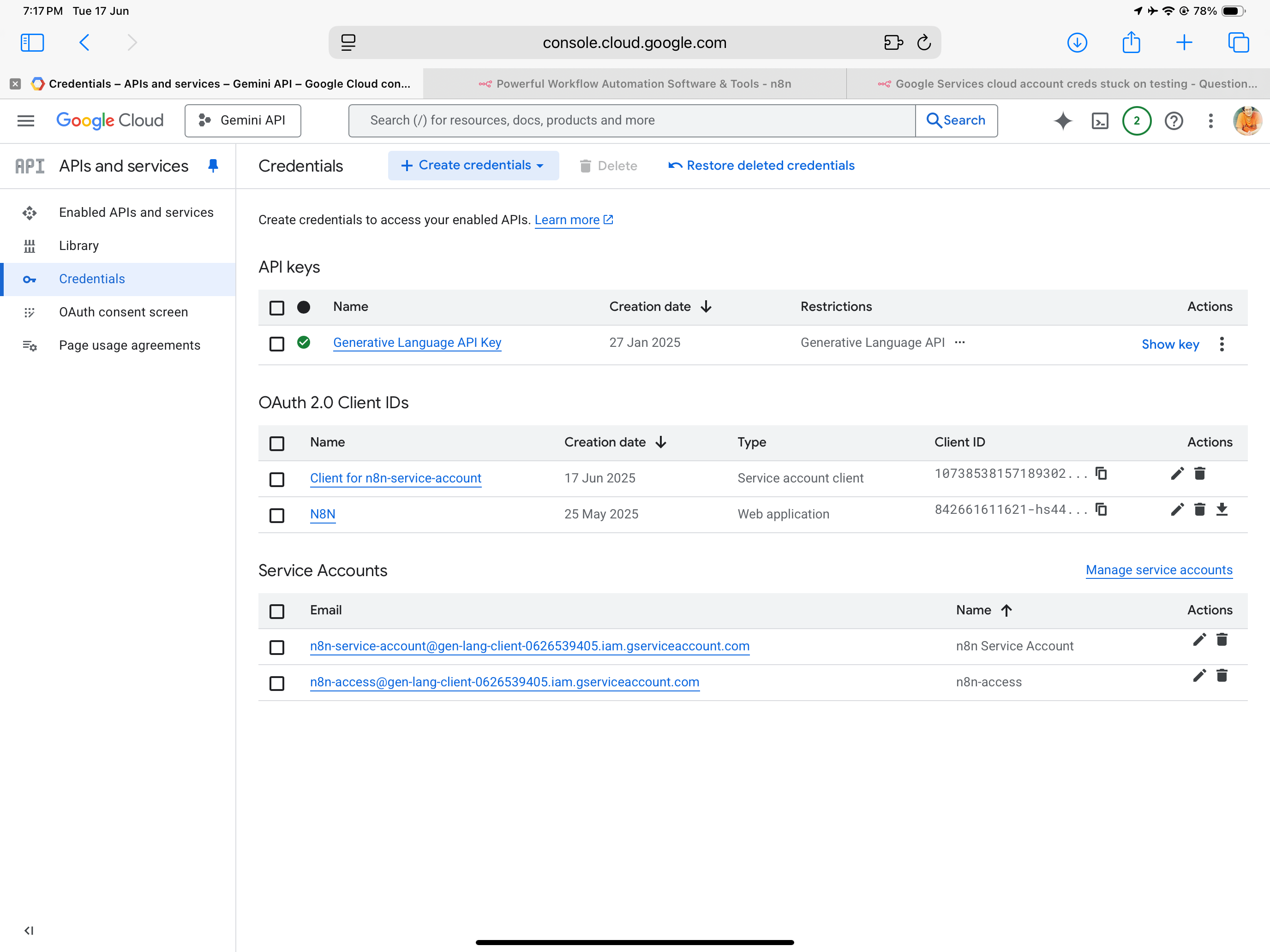

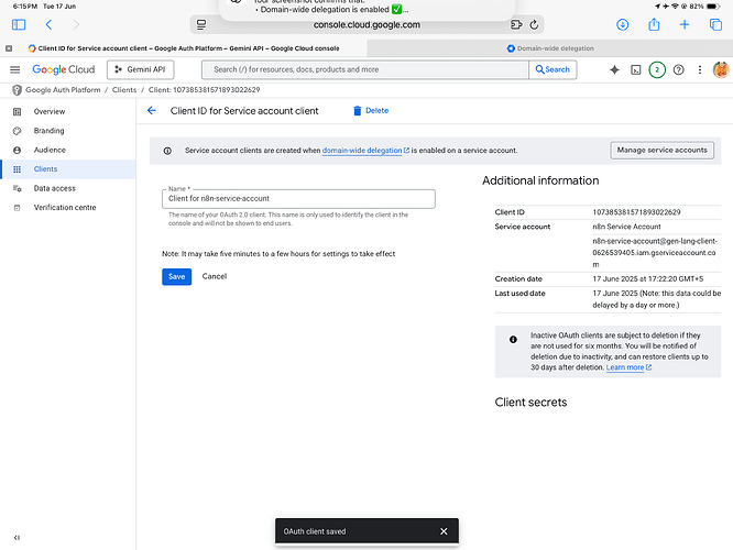

So I created a Services credential on Google Cloud for Google Sheets usage. Got the private key, service email ID. Entered that on n8n. Stuck on testing. Doesn’t move.
Adding Google Cloud pics
@darrell_tw going crazy with this :hushed_face:

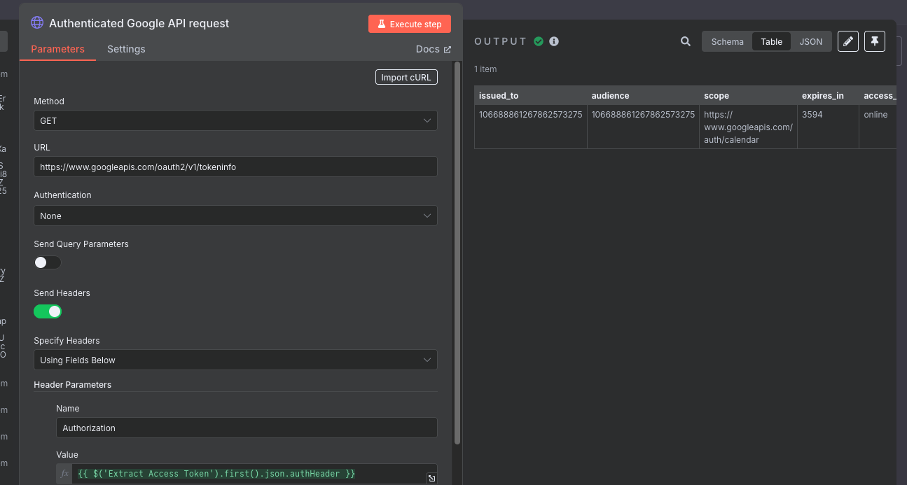

@MutedJam would love the example showing the basic auth… also running into this service account api credential stuck in “Testing” limbo …
Here you go @Jacob_Boneta:
This workflow will go through the full auth flow (without using n8n credentials), and then make an authenticated request in the last HTTP Request node. This is where you can plug in your own request:
That said, the fix linked above has been merged in the meantime, so the built-in auth should hopefully work again with the next release :slight_smile:

This worked perfectly - good workaround. I’ll add that if you want to impersonate you need to add “sub”: “[email protected]” to the payload JSON in the secure payload node. Also - instead of putting it as a “HEADER” to the API call, I used a bearer auth credential and put the expression reference to the extraction node. Worked like a charm.
