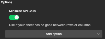

You can try enabling the option Minimize API calls in google sheet node:
If that doesn’t help much, as you mentioned you’ll need to look into solutions like queuing requests, adding delays, or replacing Google Sheets altogether..
