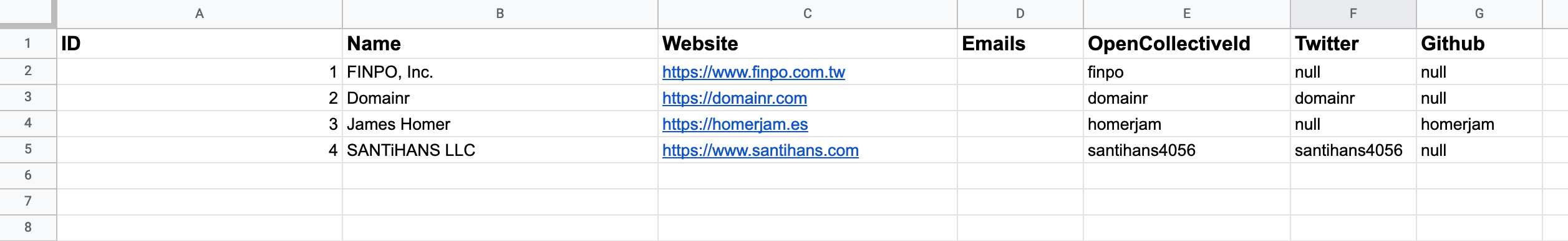

Context: I am trying to read a list of potential sponsor domains and write the emails fetched by uProc back to the sheet.
This is a screenshot of the sheet

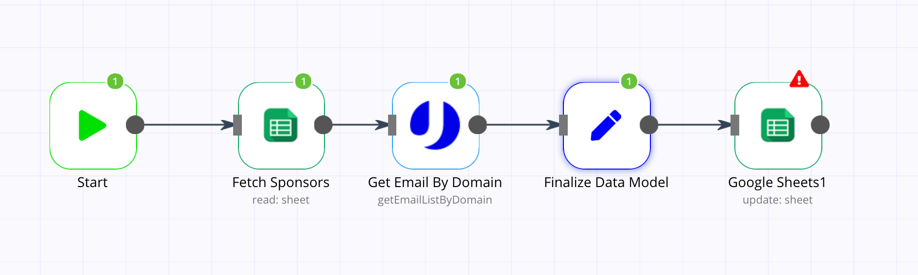

After I fetch the emails, I transform the data model as follows

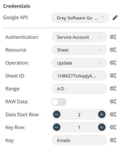

I then tried to update the sheet with the following configuration
However, I got the following error
ERROR: Could not find column for key "Emails"!
Error: Could not find column for key "Emails"!
    at GoogleSheet.updateSheetData (/usr/local/lib/node_modules/n8n/node_modules/n8n-nodes-base/dist/nodes/Google/Sheet/GoogleSheet.js:135:19)
    at runMicrotasks (<anonymous>)
    at processTicksAndRejections (internal/process/task_queues.js:97:5)
    at async Object.execute (/usr/local/lib/node_modules/n8n/node_modules/n8n-nodes-base/dist/nodes/Google/Sheet/GoogleSheets.node.js:885:34)
    at async /usr/local/lib/node_modules/n8n/node_modules/n8n-core/dist/src/WorkflowExecute.js:395:47
From the original screenshot, the email key exists. I don’t know what I’m doing wrong

The finalize data model set node merges the data from google sheets and uProc
Hi @arsalagrey
I think the best way is define Key to ID to update row. This is the row identifier and always exists.
