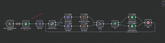

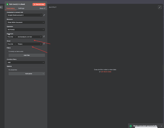

I am attempting to read each row from a google sheet, I have verified there is data on the sheet, but when I run the node, it shows there is no data.
None, just shows no data
There is no output as it is the first node.

I noticed you have multiple google sheet account credentials. Could it be that you might be using the wrong credential that is pointing to an empty table?
I’m not sure why it is outputting nothing. To me the setup looks correct.

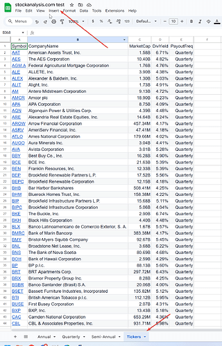

If you make the doc/sheet public, I can take a look at why it doesn’t return data and whether it works for me.
Myk3
October 6, 2025, 5:29pm
6
Sent you a pm with the spreadsheet
If you try to add a filter by clicking Add Filter(does load of your column names so you can choose like you did with sheet?)

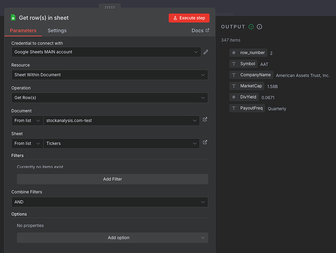

Thank you, this is what I get when I try to get rows from your document

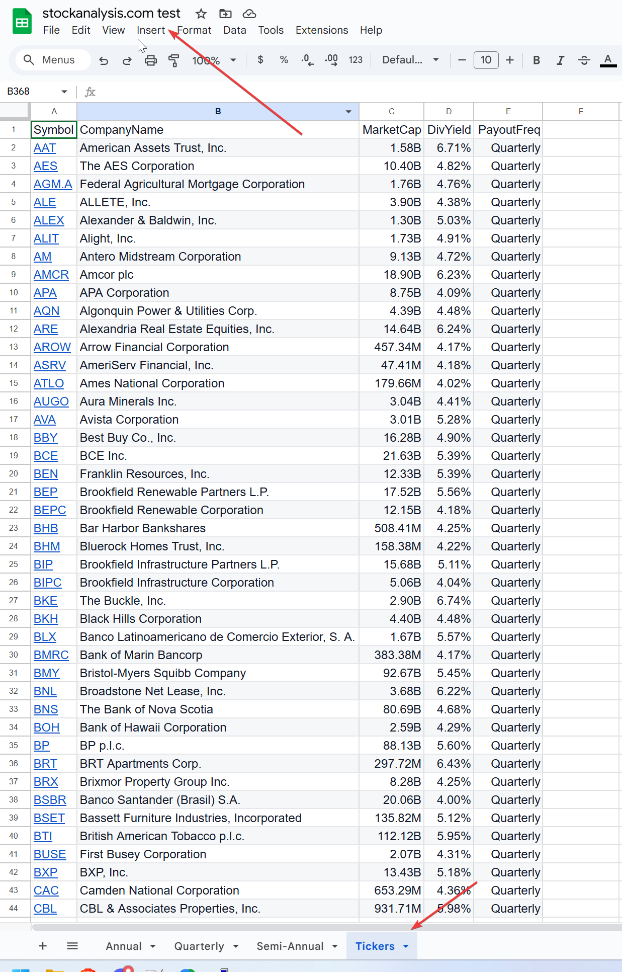

Yes it sees the sheet, name, columns, etc..
Did you rename the document - in your previous example the document name has a space and the one you shared has a dash in it.

Well, it read the file just fine for me as you can see above - read all 347 rows.
