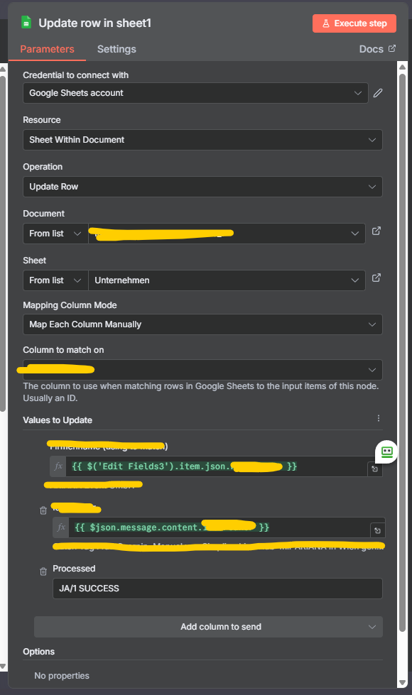

I’m using the Google Sheets node with the Update Row operation, but it doesn’t return any output data. After the update runs, the next nodes don’t get any items unless I enable “Always Output Data” or add a follow-up read. Is this expected behavior?

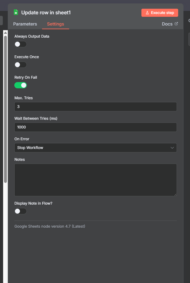

Here’s a screenshot of the node’s setup:
Its strange bcs other nodes with the same configuration have created an output.
Yes with “always output data” turned on. But the node has it turned off as you can see in the image. The others therefore too, only that in the other workflow it produces output that is passed back into the loop. I have checked for all things you recommended but the rate limit. How do I do that?

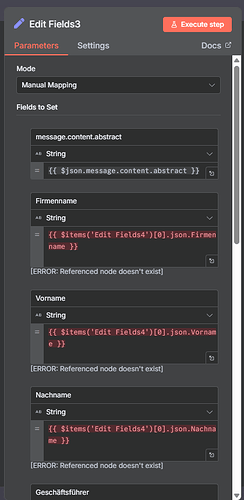

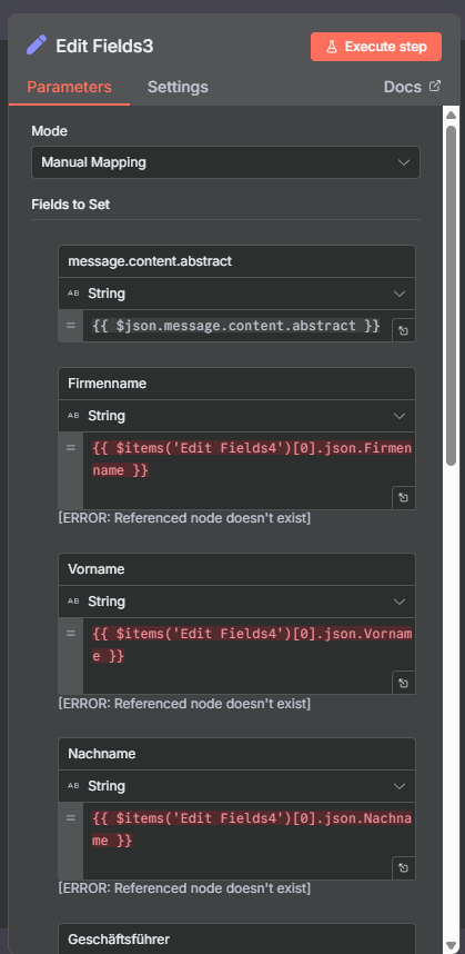

This node caught my attention “Edit Fields3”
The syntax for referencing is not correct: {{ $items('Edit Fields4')[0].json.Firmenname }}
which may cause an error when reading Firmenname (using to match), and as a result, the sheet won’t be updated and you won’t get any output
Here is the correct syntax to reference, for example:
{{ $('Edit Fields4').item.json.Firmenname }}
Please update the rest in the same way and let me know what result you get, this is most likely the issue..
I wanted to reference the first item of the 3. Do you know how else to do that?
you can try use this:
{{ $('Edit Fields4').first().json.Firmenname }}
