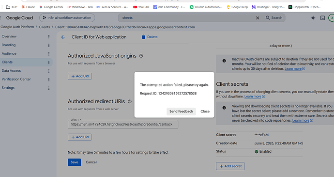

after we add redirect url error says application error

Hi @Rohit_Kulkarni
First, the “attempted action failed” popup you see in your screenshot is likely just a glitch with the Google Cloud website. To fix this, try using an incognito browser window or clearing your cache. Also, make sure you have fully filled out the “OAuth Consent Screen” section in the sidebar, as Google won’t let you save settings if the basic app information is missing.
Second, the “redirect_uri_mismatch” error happens because Google and n8n are not agreeing on the exact web address used for the login process. Think of it as a security handshake; if the address n8n sends to Google is even slightly different from the one you saved in the Google Console, Google will block the connection for security reasons.
To solve this on your Hostinger VPS, you need to make sure n8n knows its own public address. You do this by setting an environment variable called WEBHOOK_URL to your full HTTPS address. Without this, n8n might be sending an internal or incorrect address to Google, which triggers the mismatch error.
Finally, once the server setting is updated, go back to your n8n credential screen and copy the “OAuth Redirect URL” exactly as it appears. Paste that specific link into the Google Cloud Console’s “Authorized redirect URIs” field. Also, ensure your email is added as a “Test User” in the Google Consent Screen so you have permission to log in.

Please verify that you are editing an OAuth Client in a project where you have Editor or Owner permissions, try creating a new OAuth Client instead of editing the current one, wait a few minutes and try again (Google Cloud sometimes experiences temporary interface failures), test with another Google account that has administrative access to the project. In my view, the error is happening at the moment of saving the OAuth Client.
