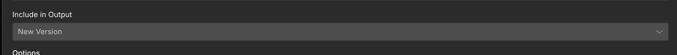

Also on the other hand, I can see that you have selected “New Version“ in the include in output field.
With this it’s going send the updated/added row as the output. (This only works when the workflow is active/published)
Since there are no updates in the sheet the concept of new or old version doesnt exist.
hence the no update.
