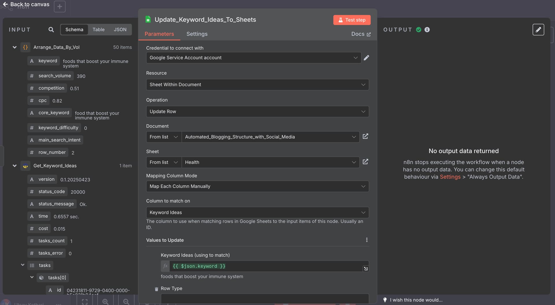

  • Using Google Sheets V2 node
  • Operation: Update Row
  • Matching by: row_number (which I extract dynamically and pass correctly)
  • Credentials: Using Google Sheets account type (not Service Account)
  • Test step shows successful execution , BUT… no data is written back to the sheet.

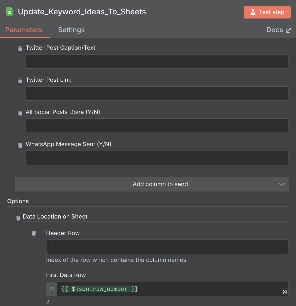

  • Set Data Location:
    • Header Row: 1
    • First Data Row: {{ $json.row_number }}

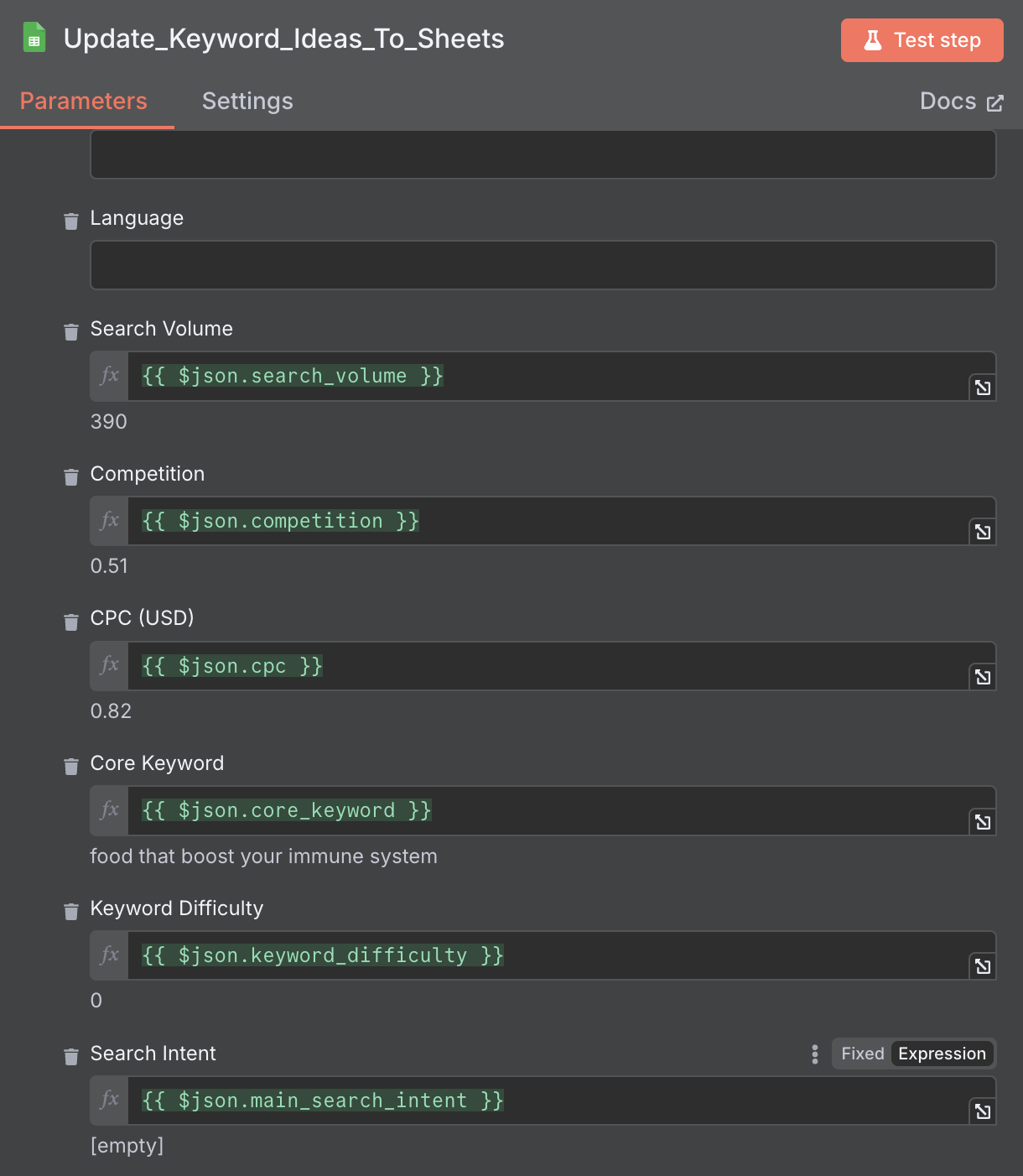

  • Set Mapping Column Mode to “Map Each Column Manually”

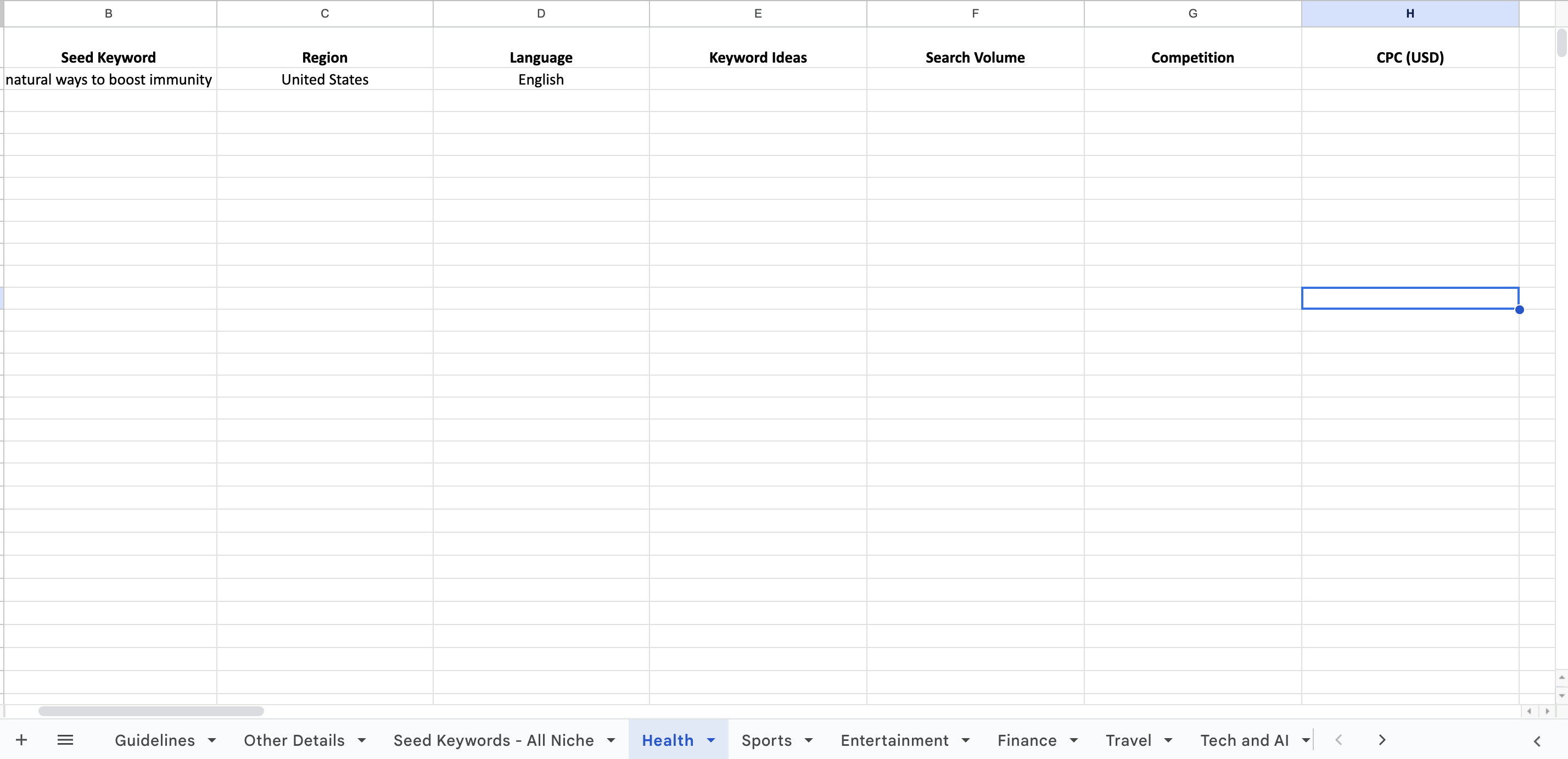

Here are screenshots of my node configuration and Google Sheet structure:

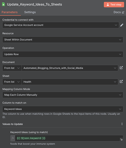

It looks like you are matching the row you want to update based on the value in the Keyword Ideas column. Wouldn’t you want that set to row_number?
The following workflow uses Google Sheets node typeVersion 4.5, and it still has the option of picking the row to update by row_number. It worked okay for me.
If it’s not just that you have things in the wrong fields, post your actual workflow/nodes in a reply and we can take a closer look.

Objective: I want to copy the output from the previous node to the sheet named “Health”. I have added an additional column in the sheet which has the row_number so that it can be mapped easily. Now, the problem I am facing is I want up date 50 rows but with update row, when all 50 are sent to be updated, only last one remains because all of them are being updated on row_number(which is 2 for now but would be different later on and cannot be edited manually every time).
We want the workflow to map for the first row_number and then, update all the extracted data(from the previous cell) starting from that row i.e. 2 in this case, and update the next rows too until the data is finished.
So, we have 50 rows which needs to be updated, if we start from row_number = 2, we want the data to be updated until row_number = 51.
I hope I was able to convey the requirements and thanks in advance for the help again.

As you can see in the image I’m using First Data Row as 3, in a hope that it starts adding the data from the row 3 onwards.
