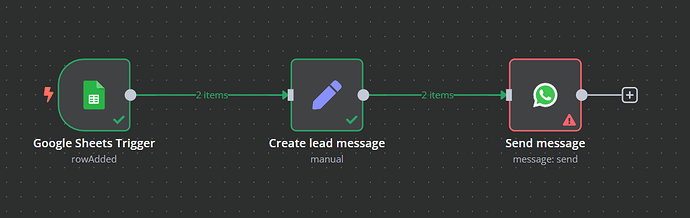

So I did a really simple setup where everytime my google forms post a new row into my spreadsheet it should send a message.
This works when I input my number in the whatsapp send message event but I have found that the reason that it fails is because the spreadsheet also returns the header data which I dont need.
Workflow is really simple
Seems like the first data that retrieves is the header data which I dont need and those fails to create the phone number.
Any solution ?

Your spreadsheet looks unusual as if indeed you have an extra row. Try changing Header Row and First Data Row values.
This is the way google forms create the spreadsheets :frowning: I also tried with a normal one and stills the same, I tink the trigger is buggy

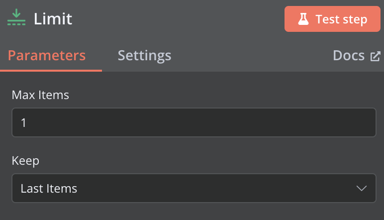

Hey @Kurcano , I don’t think it is buggy. Looks like GSheet internally represent the form data differently from the standard spreadsheet data. You can actually get rid of the first item to resolve that issue. Take a look at Limit node. If the spreadsheet always contains 2 records that you can set it up as below. If not it is also possible but will be a bit more complex that that.
