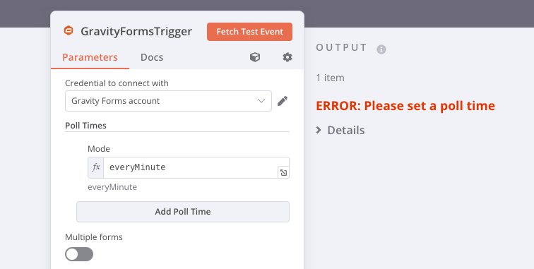

Yesterday, a user helpfully pointed out that the n8n version I was running was out of date, which was blocking our ability to push records into GoogleBigQuery. However, upon updating our version, the Gravity Forms Community Node is no longer giving an option for “Poll Times” and then erroring out because the parameter is not specified.
When I try to error it out the node just locks into a spinning “fetching event” and stays like that until I cancel the whole workflow.
Screenshot 2023-06-20 at 10.57.39 AM
Screenshot 2023-06-20 at 10.57.08 AM
There is no output generated in the updated version of n8n, but the older version generates data consistent with the Gravity Form.

Hey @Pieter_Block,
Can you confirm the version of n8n you are running? This issue should have been fixed a while back with community nodes.
We are currently using version 0.231.3 on a Docker deployment

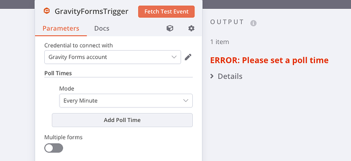

I did find that after installing the node it wasn’t there and to get it to display I had to restart my container, I would give that a bash and if that doesn’t work try using 0.233.0 which is the version I am currently running.
Good Morning,
Thanks Jon, I was able to restart the container and the Poll Times option reappeared, however I still am getting the error. Do you think downgrading is the only option here?

Hey @Pieter_Block,
Try removing the expression from the Mode field that should sort it out.
Same issue unfortunately-

Sorry I should close the loop here - we ended up just hitting their API instead of going through the node - will try that solution again with our next GravityForms request :slight_smile:

The manual execution doesn’t seem to work with this exact error. Active workflow activations do work, so seems to be an issue with the manual start specifically.
Once installed try restarting the container, I have opened an internal issue about the polling based community nodes not working correctly again.
Yeah so on instances which were running for a long time they stopped working when mannually starting the nodes/workflows.
So something is definitly broken. Could be that this is an old way of setting up the polling in the trigger node, as they are quite old nodes.
Nah they should be fine as we have not updated our internal polling trigger nodes for a while so I can’t see there being a change to that part. I think it is just how the community nodes are installed.
