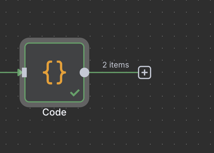

Code node might save split step.
hardcode return the [] is allowed in Code node
