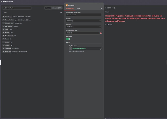

There is nothing wrong with the time, this problem is concentrates at the field where I have to fill in the “Account Name or ID”.
It should show a dropdown where i can select the correct id, but the dropdown is missing, while it was there when i first setup the node.

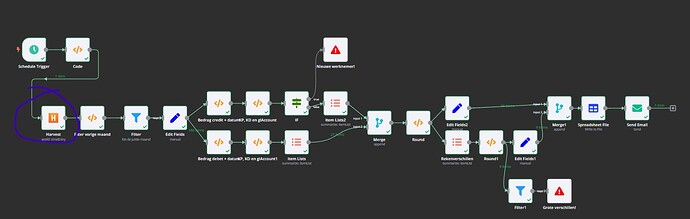

Each time i setup a new node for this, it works like it should. So then i save the flow.
And then when it gets triggered by the schuduled trigger, it doesn’t work. The “Account Name or ID” field is broken.
You can see it ran without a problem. I fixed it. (for the fourth time this year).
Next time it gets triggered, it’s like this again:
So i will have to fix it again and run it manually again, to save it again, and to find that exact same field broken again on the next triggered run.
And as you can see, the timestamp I am using is perfectly fine. This issue is about the “Account Name or ID” field breaking.

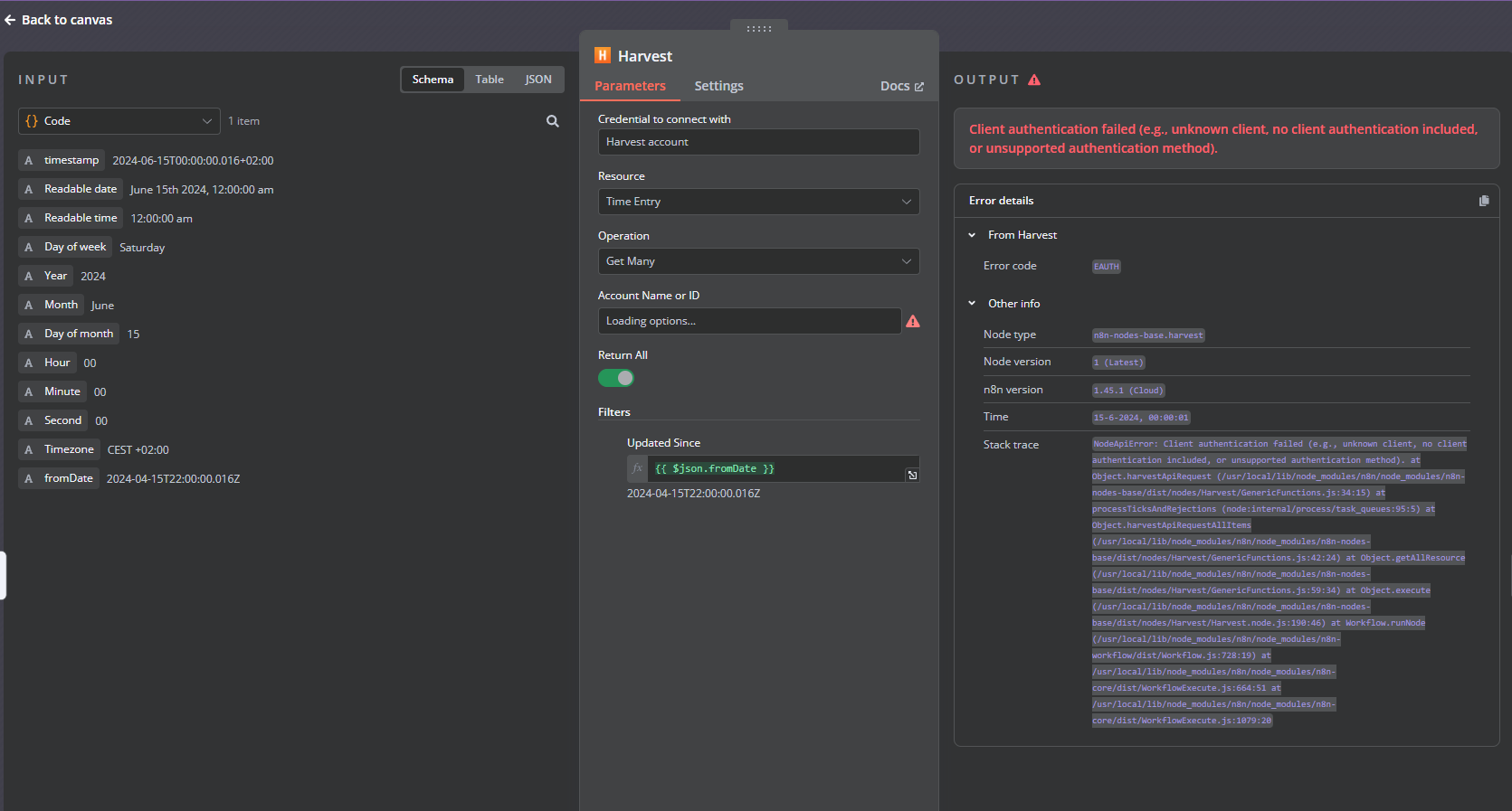

On May 29th I fixed it again:
I could select the account:
So I selected the account:
Looks good! So i save the workflow, and it should run on June 15th, midnight, by the schedule trigger.

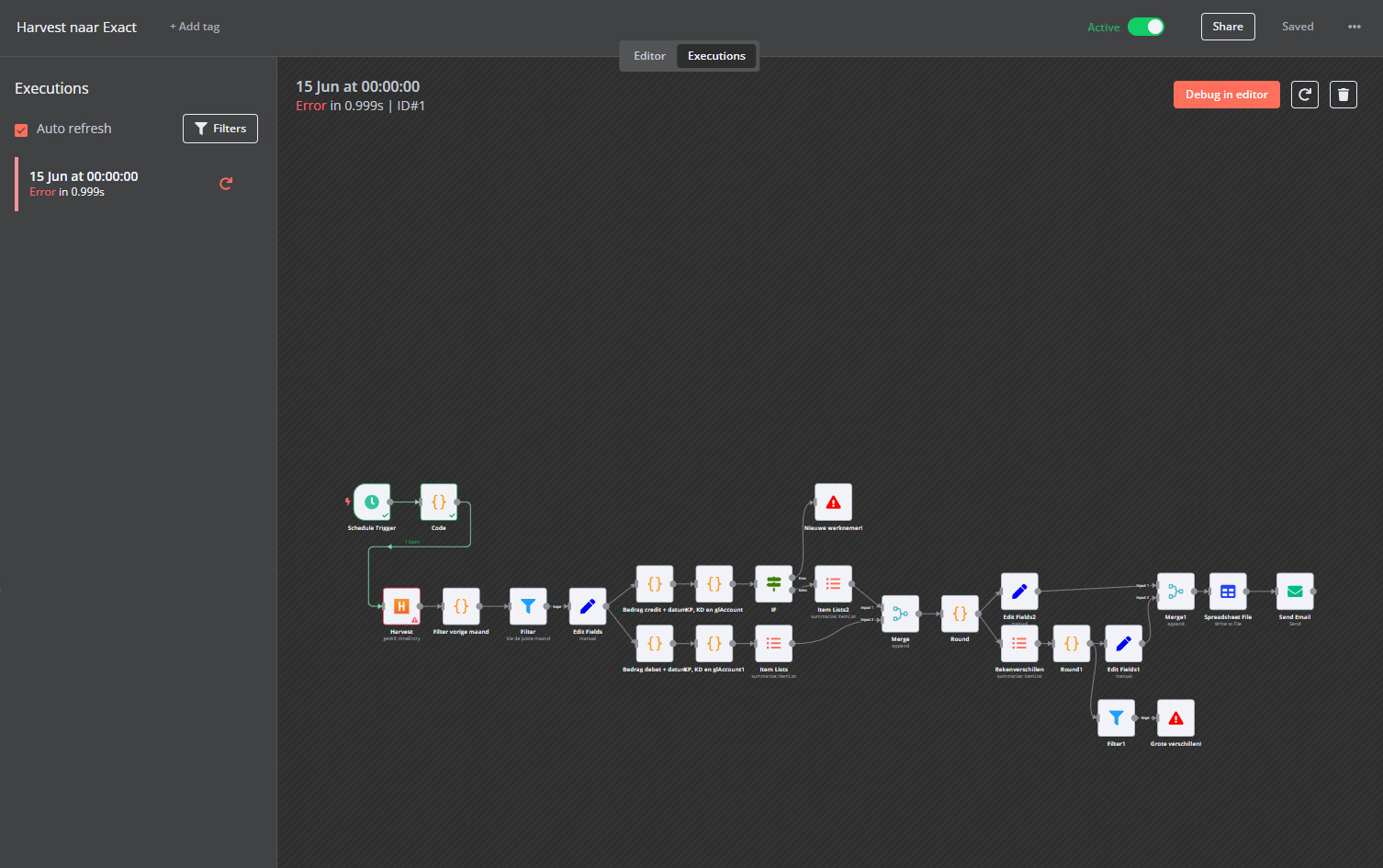

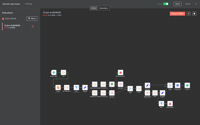

I return today, and this is what i see for the run that was triggered by the schedule trigger:
The Harvest step failed again…
So now i have to start over, delete this node, add a new harvest node, select the account, save the run, knowing it won’t run when it’s supposed to.
