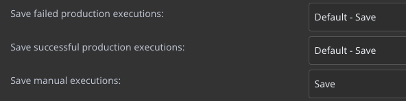

Have the option to save execution in the trigger not just for the entire workflow
The idea is:
I use n8n like this (Multiple automations per Workflow – Multiple triggers)
I have a lot of triggers fire every minute… I don’t need to keep the execution in the history, because most of the time it’s just a check of the database for example, it’s not an execution
Having these option + the timeout option
For each trigger make more sense, and make it easy to manage when having multiple automations inside the same workflow
My use case:
Keep the execution history clean, and only save the execution of the triggers that matter.

I think the first comment is another use case, also valid, and chip in here to support the main suggestion: Make the “save/do not save workflow” condition on the trigger, not the workflow itself. Or give trigger nodes the ability to override the workflow setting.
My use case to similar to OP:
  • I have a workflow with a webhook, and a 5-min scheduler.
  • I want to save all executions from the webhook, but only failed execution from the 5-min scheduler.

That’d still be a hack involving writing data in the DB and deleting it later. A conditional/selective save workflow would be welcome, it’s been proposed across multiple posts, and I can think of many ways to implement it: save/donotsave execution based on execution time, based on trigger type, based on some value during the workflow, based on a node present/absent along the workflow execution, etc. Or a 16th node on top of the current 15 n8n action nodes that would be superseed the workflow save/donotsave settings.
