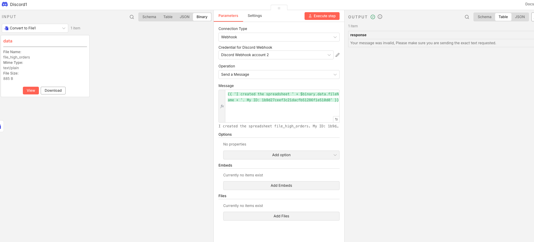

I’m having problem with sending messages to discord. All my settings are correct. but i got each time a response of that (Your message was invalid, Please make sure you are sending the exact text requested.)

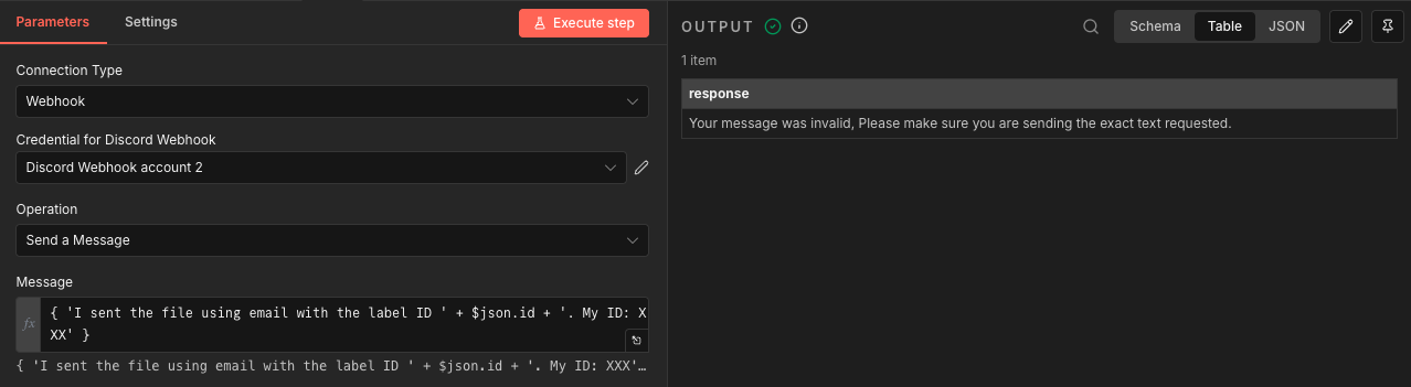

“nodes”: [
“parameters”: {
“authentication”: “webhook”,
“content”: “={ 'I sent the file using email with the label ID ’ + $json.id + ‘. My ID: 1b9d27ceef3c21dacfb51286f1e510d0’ }”,

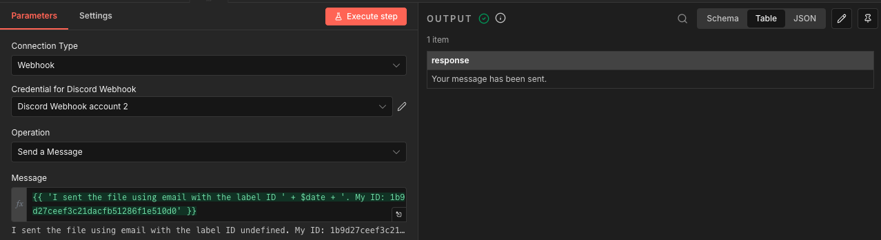

It seems to be related to the content message.
Make sure to use {{ }} around your expression + use the correct apostrophe symbol ‘
Your content message :
what you should define :
{{ ‘I sent the file using email with the label ID ‘ + $json.id + ‘. My ID: 1b9d27ceef3c21dacfb51286f1e510d0’ }}
If you still face the issue, please send a screenshot and the expression you put in the message field

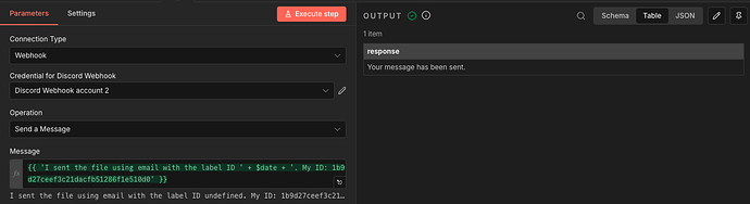

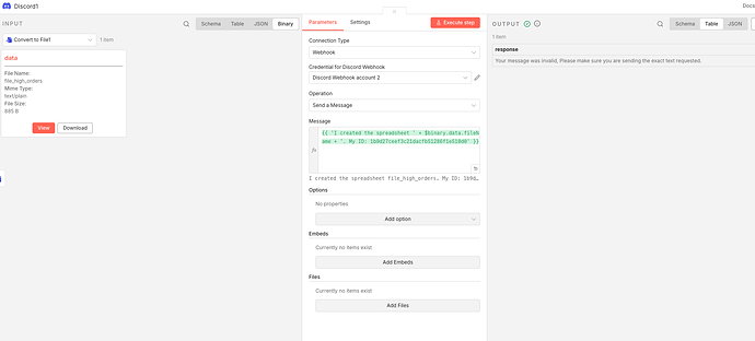

Hi, the first discord node is succeed :grinning_face: thanks to your solution,
But i’m still having issue with the second one, where i need to send a binary file. :pensive_face:
And also with workflow 3 with error trigger connect to discord node. :pensive_face:

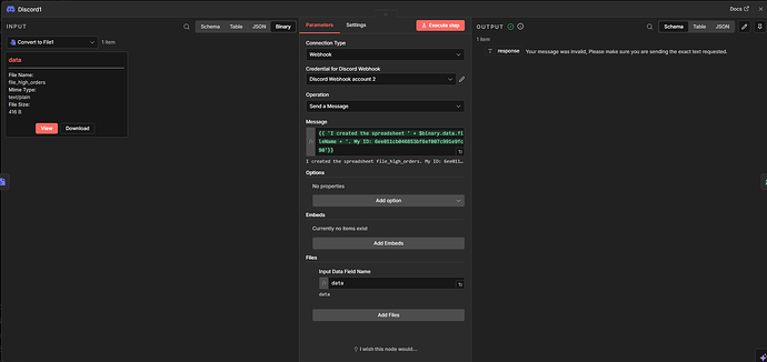

I have tried everything. even with ChatGPT but still i get the invalid message.
Strange…
Here is my message content that works.
Try to copy/paste and test it :
{{ 'I created the spreadsheet ’ + $binary.data.fileName + ‘. My ID: 04f8d076550b2517ab0b57cf5c16b364’}}
Now i’m having error :face_exhaling:
Yes, I don’t know why but all apostrophe changes when paste from this blog.
Retype all apostrophes with your keyboard on the expression pasted and it should be fine.

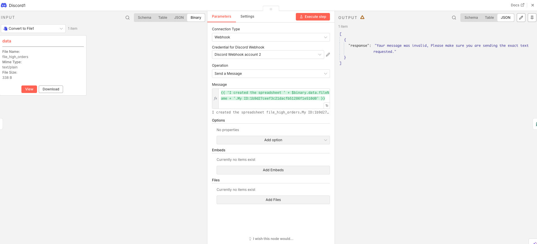

Hello,
I am having the exact same problem. I tried using the exact message proposed but it still doesn’t work on workflow 2 and 3. Could you provide some help? :slight_smile:
Regards
Hi @Nairo
Did you try to rewrite the apostrophes after pasted the message?
