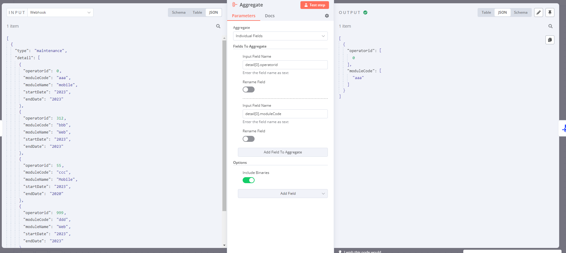

how do i get only the announcement id and language code in a set of data and then upload the announcement id inside “opid” folder, and inside the “opid” folder is sub folder for languageCode named “lcode” in aws s3 and then loop it all through other 207 data
here are my sample codes:

That said, instead of the ‘Aggregate’ node, you’ll need to use the ‘Split Out’ node to turn the detail array into separate items.

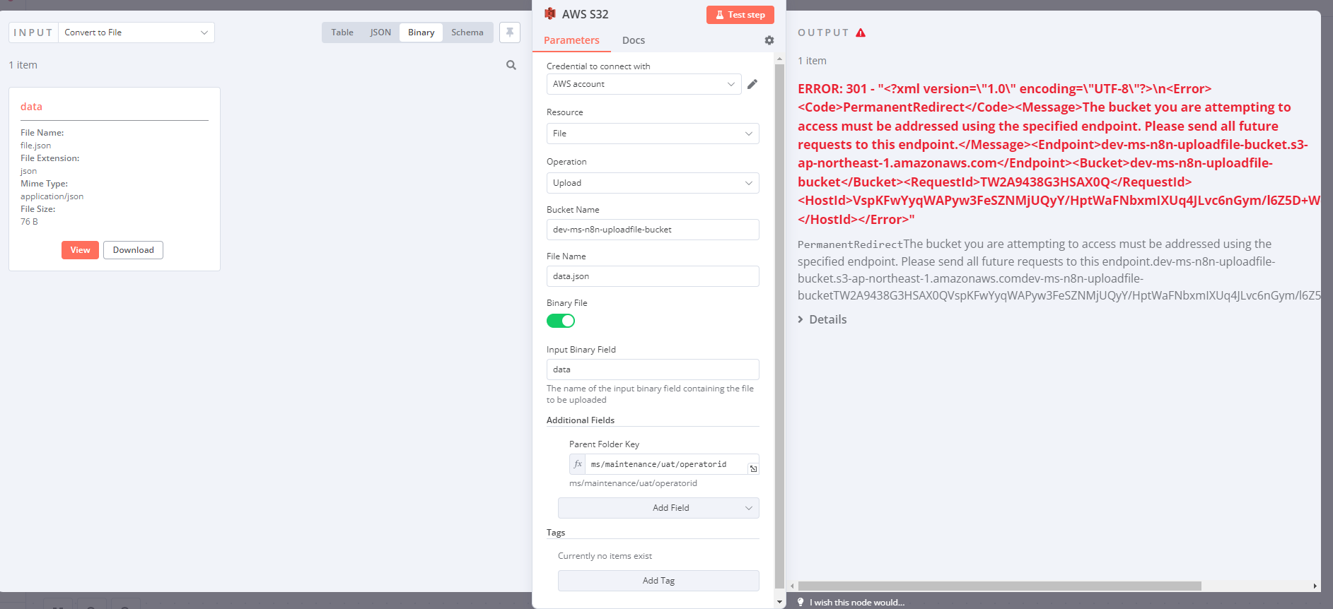

it returned an error
i used the split out node it worked, thank you
I think the solution is in the error message?
