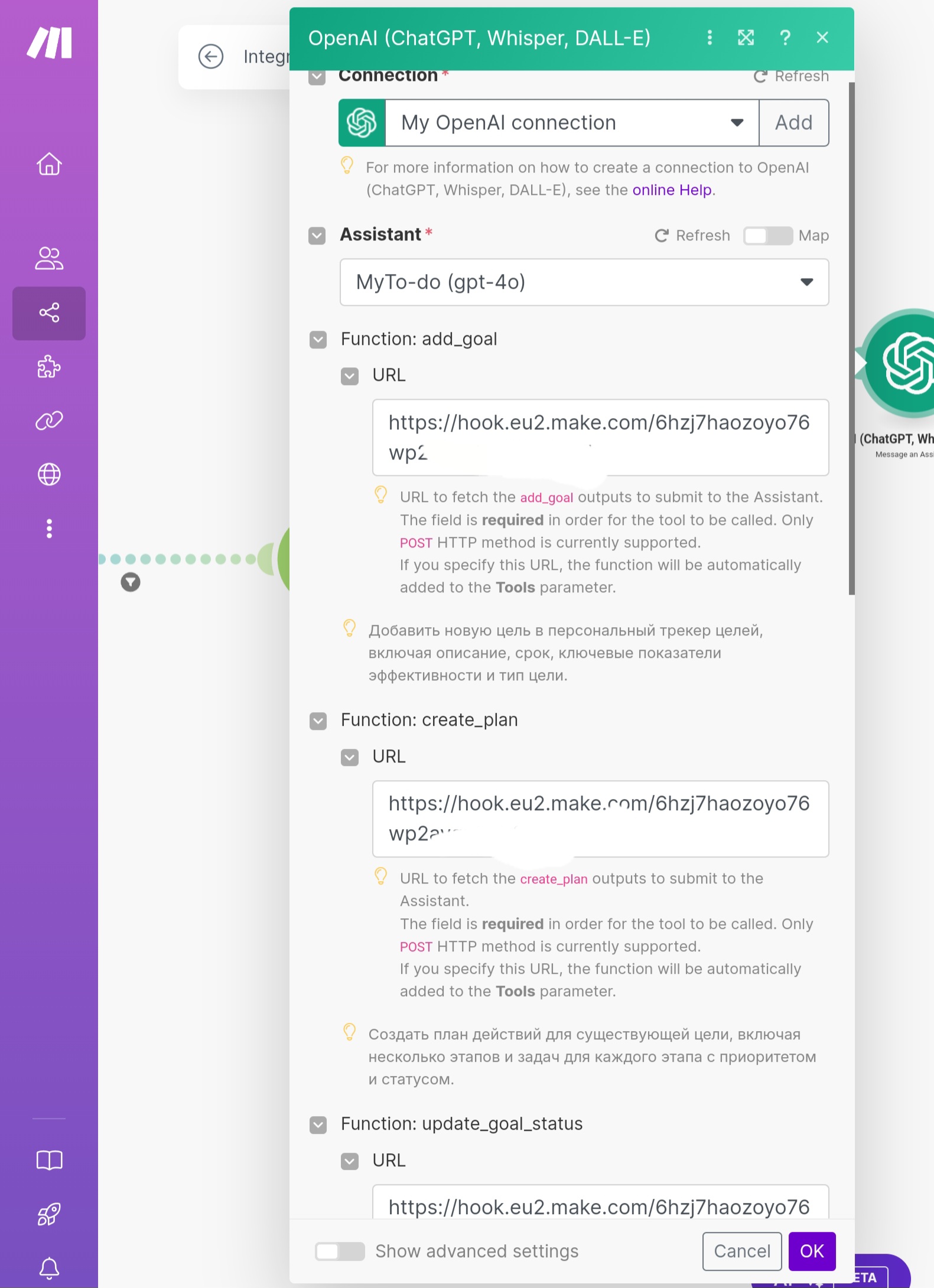

I’m trying to transfer the workflow from Make to n8n, but I don’t understand how to organize such a scheme!
The node in Make can accept instructions from OpenAI, but the node in n8n does not have such capabilities, please tell me how to organize such a process?

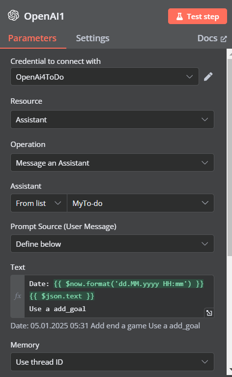

You can use either dedicate Open AI node or generic AI Agent connecting Open AI model to it if you are tide up to OpenAI specifically.
Yes, I use these nodes, but none of them “pull” Functions from the platform the same way as in Make!

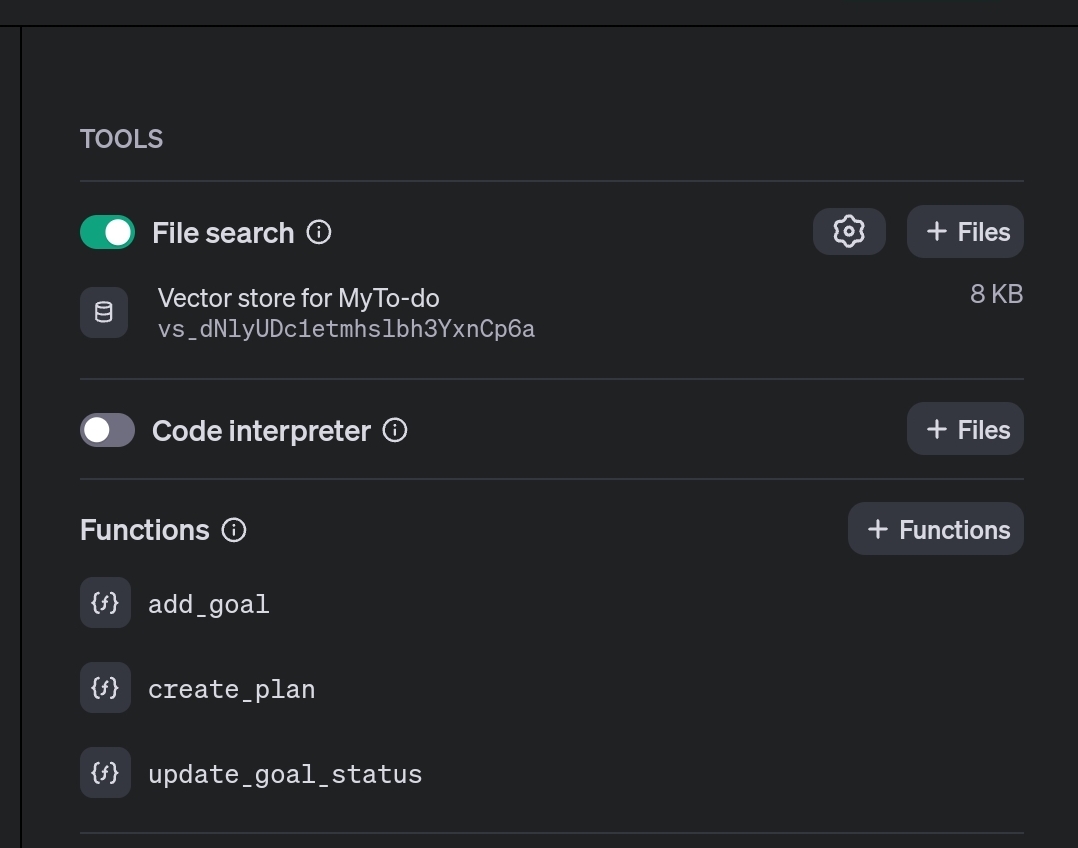

It seems that in n8n it is possible to fully implement the AI ​​assistant, but it is impossible to fully use all the capabilities of the Assistant from platform.openai.com?!
Because there is no understanding of how to use functions from platfom in n8n. In fact, on platform.openai.com in the Assistant, I have described the data structure functions for adding/updating fields in Notion.

But after one unsuccessful processing of the tool, the AI ​​no longer wants to access this tool for debugging and constantly writes:
None of your tools were used in this run. Try giving your tools clearer names and descriptions to help the AI

The AI ​​tools module, when using the assistant from platform.openui, writes its code in Functions and does not take Functions from the assistant. There is also a problem, if we use Tools and try to write data from AI, then it does not follow the instructions (transferring data of the required structure), but gives an empty request…
