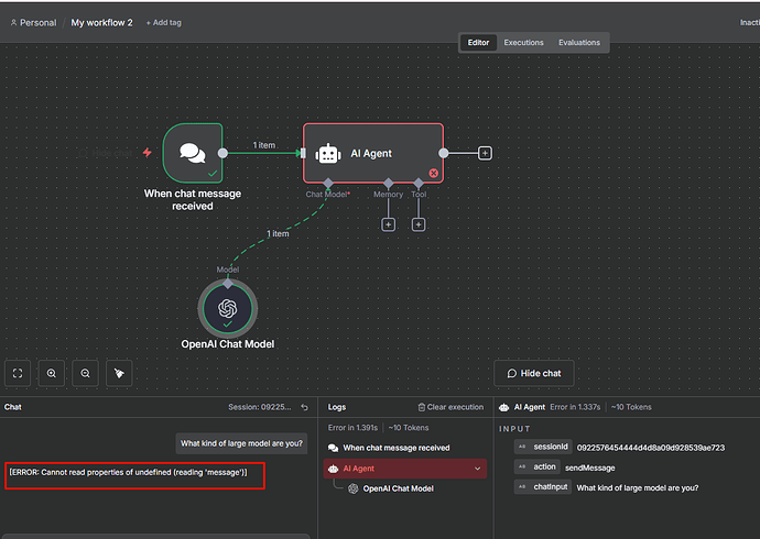

Help me out—the AI agent node ran successfully, but the returned content has some issues
In N8N, I used the AI Agent to call the DMX API integration model. It showed a successful connection, but when inputting content to the large model, it only returned the error: “Problem in node ‘AI Agent’. Cannot read properties of undefined (reading ‘message’)”. However, connecting to other official large model APIs does not exhibit this issue.
[ERROR: Cannot read properties of undefined (reading 'message')]

  • **n8n version:**1.110.1
  • Database (default: SQLite):no
  • n8n EXECUTIONS_PROCESS setting (default: own, main):main
  • Running n8n via (Docker, npm, n8n cloud, desktop app): desktop app
  • Operating system:window11

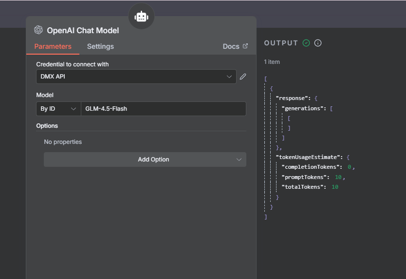

Hi @skyeak,
This issue is most likely coming from the provider, not from n8n.
In many cases, unofficial OpenAI providers experience problems because their OpenAI-compatible backends tend to have a lot of bugs.
Unfortunately, there’s not much you can do on your end.
If you’re not able to use OpenAI directly, try using a well-known provider like OpenRoute, Requesty..etc.
