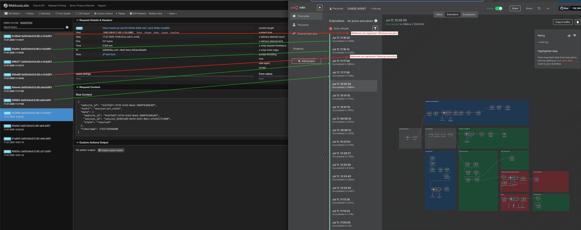

We are using n8n for a chatbot integration (with crisp). The problem we have is that not always the automations starts, although the web hooks are sent successfully by crisp platform. From crisp we send 2 webhooks, one to webhook.site (the monitor) and one to n8n.

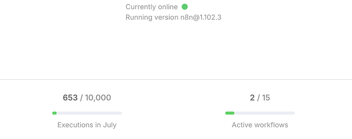

  • n8n version: 1.102.3
  • Running n8n via: n8n cloud (Pro plan)
Usage stats
